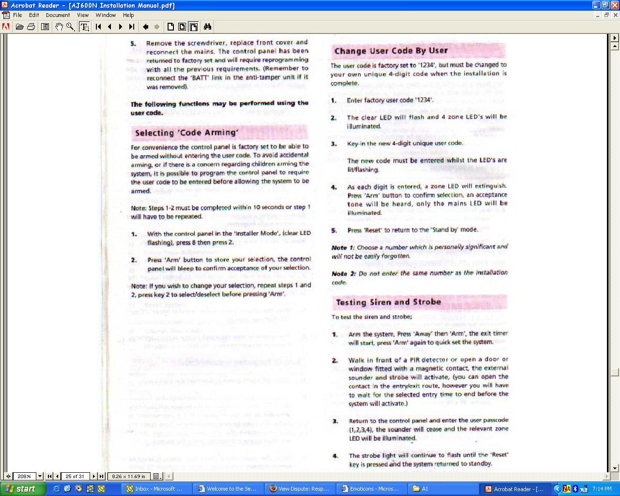

norman Posted February 9, 2005 Share Posted February 9, 2005 There is limited 'user' functions and unfortunately we do not give out installer manuals on this site, I have however screen grabbed this for you. Nothing is foolproof to a sufficiently talented fool. Link to comment https://www.thesecurityinstaller.co.uk/community/topic/5035-aj600n-manual-needed-please/#findComment-39895 Share on other sites More sharing options...
