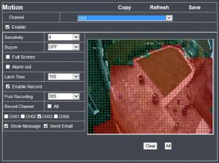

The above screen shows the way in which the motion detection is setup, using the typical ‘tiles’ setting as seen in many other DVRs.

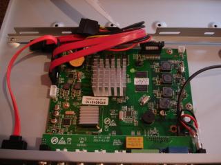

Similar to the analogue versions, and with the GUI looking identical, this DVR runs a Linux based operating system, the quality of the PCB and components are superb. The PCB was clean and the SMT components neatly arranged; nothing skewed or covered in stray flux or glue. There are no fans on any of the models as far as I am aware.

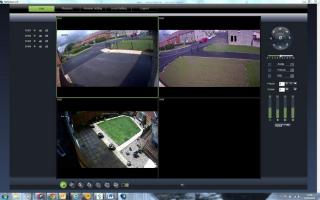

My customer has had the unit for just over a month now, and is very pleased with the quality of the images, as ever he is very glad he didn’t buy a cheap ‘kit’ but it’s only now he’s seen the difference (neatly highlighted by using substream remote connections, which are highly compressed of course) that it becomes obvious; especially as this application needs to be able to read VRNs – for vehicles whose drivers would rather follow their sat nav over a former road than common sense!
HD Images

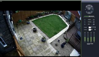

Day / Night function of Camera
Day

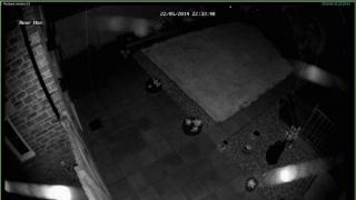

Night (with no background lighting or nearby street lighting)

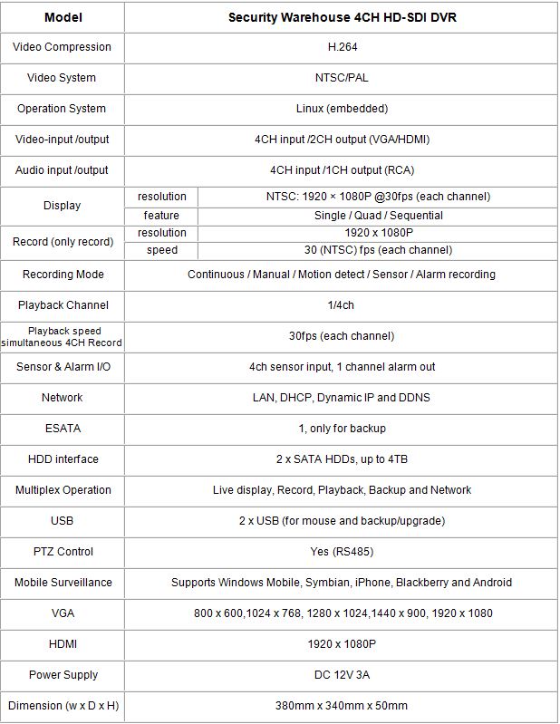

Specification
Please Note – 3A PSU supplied with DVR; if more than 1 non ‘eco’ type HDD fitted a larger PSU may be required.
