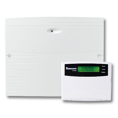

momo Posted January 6, 2014 Share Posted January 6, 2014 Hi, It's my 1st post here so be gentle please The system I have looks pretty much like this: Since the weekend though when we try to set the alarm instead of setting in the usual way (we always do a full set, never partial) it comes up with a strange message. I apologise in advance, i've not had time to take a note of it as each time i've tried to set it i've been running late to go out. Where usually it should say "Full set suite zones..........." It now comes up with a message along the lines of "Full set suite zones ...........P". And instead of setting correctly it continually beeps (pretty quick beep, like 2 beeps a second). Both the control panel and the main box containing the battery beep like this. So it has a P on the end but only when setting the alarm. If unset, it looks normal. From reading the user manual it says it'll be a power related problem. Has anyone seen anything like this or can confirm what the problem is? I have a feeling the battery is dying.. Thanks in advance. Mo Link to comment https://www.thesecurityinstaller.co.uk/community/topic/35913-help-needed-for-veritas-excel/ Share on other sites More sharing options...
