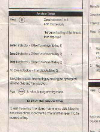

CompostCORNER Posted August 22, 2004 Share Posted August 22, 2004 Accentas do have a programmable service timer. What happens with it though is when it's getting close to it's time, it puts a flashing tamper lamp on the RKP. Coincidentally, I had one last week on call duty and the customer thought the alarm was in fault. As those who know about the Accenta will tell you, a real tamper on the system locks the keypads so they seem unresponsive. Tony Link to comment https://www.thesecurityinstaller.co.uk/community/topic/3375-service-warning/#findComment-21284 Share on other sites More sharing options...

Guest Mduncan00 Posted August 22, 2004 Share Posted August 22, 2004 I agree ! Never heard of an accenta with service timmer Mike Link to comment https://www.thesecurityinstaller.co.uk/community/topic/3375-service-warning/#findComment-21325 Share on other sites More sharing options...
CompostCORNER Posted August 22, 2004 Share Posted August 22, 2004 I agree ! Never heard of an accenta with service timmerMike 21325[/snapback] Yeah. Looks like you're right there. Apologies from me. Looks like my manual has a serious printing error in it. Link to comment https://www.thesecurityinstaller.co.uk/community/topic/3375-service-warning/#findComment-21333 Share on other sites More sharing options...
Brian c Posted August 22, 2004 Share Posted August 22, 2004 If you don't know......ask. Link to comment https://www.thesecurityinstaller.co.uk/community/topic/3375-service-warning/#findComment-21335 Share on other sites More sharing options...
