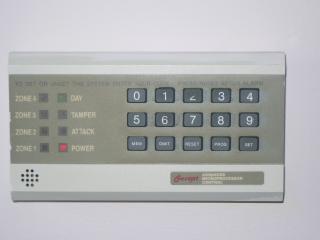

Stephen1984 Posted May 12, 2009 Share Posted May 12, 2009 I have hopefully attached a photo uploaded by another user which is the exact alarm which is fitted in my property. Basically the alarm is fitted in a two bed terraced house with one trigger in the front room (which has a delay) and one trigger in the kitchen at the back off the house which sets the alarm off immediately, the problem that i have is that the stairs come down into the kitchen so if i want to have the alarm on over night when i come down in the morning the alarm is triggered as i do not get a delay to input the number. I think there is a pressure mat on the stairs which does not work so i want to adjust the zone so it has a delay. Can anyway help???????? Link to comment https://www.thesecurityinstaller.co.uk/community/topic/28644-want-to-adjust-zone-profiles/ Share on other sites More sharing options...
Rulland Posted May 12, 2009 Share Posted May 12, 2009 The system will have to be programmed with a 'night' or 'part' set to allow what you require, this is usually done via engineer/installer mode and not via customer access. You will require an engineer to set up the features as needed-unless of course you have the engineer code and feel competant to do the mods!-IMHO not the way to go, insurance etc if you get it wrong . Richard. Link to comment https://www.thesecurityinstaller.co.uk/community/topic/28644-want-to-adjust-zone-profiles/#findComment-237117 Share on other sites More sharing options...

lawandorder Posted May 12, 2009 Share Posted May 12, 2009 The system has never worked how i would want it to since i moved in, i am just presuming that the mat will be a seperate zone which provides a delay when coming downstairs in the morning.I shall have a look at the mat and look into replacement. Thanks again. Others may advise otherwise but I am pretty sure that the panel you have only has one final exit zone (zone 1) so it is likely that the detector you have at the front of the house is on zone 1 along with the pressure mat. Link to comment https://www.thesecurityinstaller.co.uk/community/topic/28644-want-to-adjust-zone-profiles/#findComment-237123 Share on other sites More sharing options...
