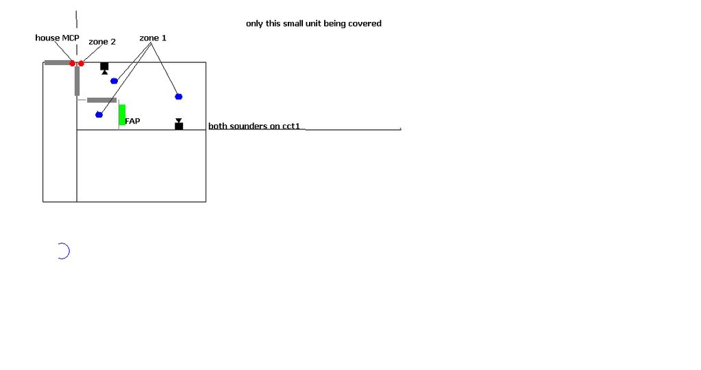

Guest Cerberus NI Posted January 6, 2008 Share Posted January 6, 2008 Hmmm,so if you have say a print room and a switch room on the ground floor of a building do you consider it better practice to have these rooms on the general zone for the ground floor with all of the other devices or are they not better to be identified seperately to aid faster response times?? 18 years at this and never thought of it as a problem (although I do draw the line in the case where devices on an addressable system are each given there own zone - seen it done on more than one occassion!! ) Link to comment https://www.thesecurityinstaller.co.uk/community/topic/21804-en54-vs-bs5839/#findComment-187685 Share on other sites More sharing options...
Number2 Posted January 6, 2008 Author Share Posted January 6, 2008 I thought id do a diagram to show better what i mean, i agree places of high risk eg, print room, boiler room ect might be better off on own zone to help identify the source but i mean a zonal boundaries being conflicting. sorry for the poo paint skills i have. "I told you i was testing the alarm today" "Yeah but my staff and the shopping centre didnt know" "oooops" "PLEASE EVACUATE THE SHOPPING CENTRE, THIS IS A FIRE ALARM ACTIVATION" repeats in the background. My finest hour! Link to comment https://www.thesecurityinstaller.co.uk/community/topic/21804-en54-vs-bs5839/#findComment-187700 Share on other sites More sharing options...
