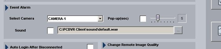

Howi Posted December 26, 2007 Author Share Posted December 26, 2007 Hi Peter thanks for the reply, I have resolved this by uninstalling and this time clearing out manually all the folders associated before re-installing. seems ok, ie i have event data after 4pm from last night now. I have the correct sw for both the server and client. There are a few other problems with the system such as; If you check the client event sound pop up then you can't ever deselect this feature? I have problems with the client playback, the play & stop buttoms seem to have no effect whatsoever? these are not causing me that much grief but i thought you would appreciate the feedback on the system. Steve. Link to comment https://www.thesecurityinstaller.co.uk/community/topic/21737-x-vision-scheduler/#findComment-186957 Share on other sites More sharing options...
