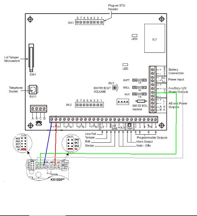

ScorpioInstallations Posted October 5, 2007 Share Posted October 5, 2007 Just like tha ! Huh Huh ha do you know why when the alarm is set, when i move across the pir the light goes blue and i hear a click in the control box but the alarm does not sound or go off. Post a Diagram fist so we can see how you've weired your bell. Never Teach Your Apprentice Everything You Know Link to comment https://www.thesecurityinstaller.co.uk/community/topic/20922-galaxy-16-wiring-pir/page/2/#findComment-180296 Share on other sites More sharing options...
Guest anguscanplay Posted October 5, 2007 Share Posted October 5, 2007 OK that make sence thanks.do you know why when the alarm is set, when i move across the pir the light goes blue and i hear a click in the control box but the alarm does not sound or go off. thanks for all your help cause you said at the top you aint connected the blue and yellow wires ? you will probably have to " tell " the curcuit to work using the programming but we aint really supposed to post how THAT goes edit: just read you say it clunks in the control box doh you`ll have your bell wrong, like mr whitenoise says " drawing would help....." Link to comment https://www.thesecurityinstaller.co.uk/community/topic/20922-galaxy-16-wiring-pir/page/2/#findComment-180297 Share on other sites More sharing options...
andyrav Posted October 5, 2007 Author Share Posted October 5, 2007 Thanks i have wired it as per your diagram i have not wired a bell yet. just added a horn when i set the alarm and i walk past the pir the relay in the control pannel clicks but there is not sound from the horn and it does not say anything on the lcd panel. if i add a pannic button to zone 1 and activate it that works both in set and unset mode the Pir is on zone 2 Thanks Just like tha ! Huh Huh ha Post a Diagram fist so we can see how you've weired your bell. Link to comment https://www.thesecurityinstaller.co.uk/community/topic/20922-galaxy-16-wiring-pir/page/2/#findComment-180304 Share on other sites More sharing options...
ScorpioInstallations Posted October 5, 2007 Share Posted October 5, 2007 i have not wired a bell yet.just added a horn when i set the alarm and i walk past the pir the relay in the control pannel clicks but there is not sound from the horn and it does not say anything on the lcd panel. if i add a pannic button to zone 1 and activate it that works both in set and unset mode the Pir is on zone 2 How is the PIR programed? How are you setting the alarm? Never Teach Your Apprentice Everything You Know Link to comment https://www.thesecurityinstaller.co.uk/community/topic/20922-galaxy-16-wiring-pir/page/2/#findComment-180306 Share on other sites More sharing options...
