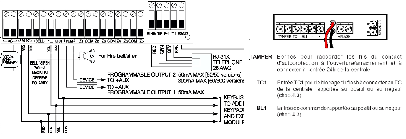

SOFIENE Posted August 29, 2007 Share Posted August 29, 2007 Hi to All Can you please help me to connect the Extern_Auto-Alimentate-SIREN (on the right) to my House_DSC-Alarm (on the Left) ? Thanks Link to comment https://www.thesecurityinstaller.co.uk/community/topic/20549-extern_siren-and-dsc_alarm_central/ Share on other sites More sharing options...
IPAlarms Posted August 29, 2007 Share Posted August 29, 2007 Hi to AllCan you please help me to connect the Extern_Auto-Alimentate-SIREN (on the right) to my House_DSC-Alarm (on the Left) ? Thanks My French is not so good these days, so it's difficult to know from the documentation exactly what TC1 and BL1 are. I'm guessing BL1 is bell trigger. Can you translate the descriptions for us ? My guess is as follows: SIREN + to +BELL SIREN - to AUX - BL1 to -BELL Program Zone 6 as 24 hour and wire in the two tamper terminals from the siren. Anyone disagree - or can back me up ? Free Alarm Monitoring over the Internet from IP Alarms Link to comment https://www.thesecurityinstaller.co.uk/community/topic/20549-extern_siren-and-dsc_alarm_central/#findComment-176707 Share on other sites More sharing options...
arfur mo Posted August 29, 2007 Share Posted August 29, 2007 My French is not so good these days, so it's difficult to know from the documentation exactly what TC1 and BL1 are. I'm guessing BL1 is bell trigger. Can you translate the descriptions for us ?My guess is as follows: SIREN + to +BELL SIREN - to AUX - BL1 to -BELL Program Zone 6 as 24 hour and wire in the two tamper terminals from the siren. Anyone disagree - or can back me up ? i'd expect that would just work fine, if just bit unconventional to the norm. nothing wrong in that for this job (unless your looking after the crown jewels while HRM is onher summer hols ), like most panels is there not a separate terminal block section marked for "SAB" or "external siren" on this panel (i don't use these to know)? if so thats where these connections should normally come from. if you use the internal bell output, then you will have external bells/siren should a tamper contact 'drop' or a false set happens, can be a tas startling lol! regs alan regs alan If you think education is difficult, try being stupid!!!! Link to comment https://www.thesecurityinstaller.co.uk/community/topic/20549-extern_siren-and-dsc_alarm_central/#findComment-176710 Share on other sites More sharing options...

SOFIENE Posted September 3, 2007 Author Share Posted September 3, 2007 Thank you Virtual Monitoring .. Here is the translate of the SIREN Devises : TC1 : entry for the blocking of the flash, connected to the Central TC, brought back to positive or the negative one BL1 : entry of order, brought back to positive or the negative one Thanks again. Link to comment https://www.thesecurityinstaller.co.uk/community/topic/20549-extern_siren-and-dsc_alarm_central/#findComment-176943 Share on other sites More sharing options...
SOFIENE Posted September 5, 2007 Author Share Posted September 5, 2007 To Virtual Monitoring .. I'm waiting for your advice about the right connect of the TC-SIREN device .. Thanks for All Link to comment https://www.thesecurityinstaller.co.uk/community/topic/20549-extern_siren-and-dsc_alarm_central/#findComment-177135 Share on other sites More sharing options...
