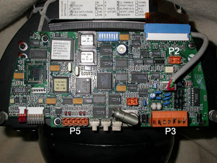

Camera123 Posted August 8, 2007 Share Posted August 8, 2007 Where can I find wiring / hook up info to test or use a sensormatic speeddome 2000, label says 24V AC, but to what connector or pins ? Link to comment https://www.thesecurityinstaller.co.uk/community/topic/20197-sensormatic-speeddome-2000/ Share on other sites More sharing options...

safe_observation Posted August 15, 2007 Share Posted August 15, 2007 hi if you use pelco-d protocols. i believe you can use other controllers. PC controling is not too bad, but speed dome usually is a multi-funcions. PC will only activate a few functions like pan/tilt/zoom, but you need joystick to set up the tour and presets. to power on the speed dome, you need to get a AC24V power transformer. -- there may be two kinds of the power in of the dome -- one is plug and use. the other is a connectors that requires you to cut down the jack then make two naked wires to connect to the power leads of the dome. thanks Please read the forum rules on advertising before reposting you signature. also your image is far to big. Link to comment https://www.thesecurityinstaller.co.uk/community/topic/20197-sensormatic-speeddome-2000/#findComment-175211 Share on other sites More sharing options...
Camera123 Posted August 20, 2007 Author Share Posted August 20, 2007 hi if you use pelco-d protocols. i believe you can use other controllers. PC controling is not too bad, but speed dome usually is a multi-funcions. PC will only activate a few functions like pan/tilt/zoom, but you need joystick to set up the tour and presets. to power on the speed dome, you need to get a AC24V power transformer. -- there may be two kinds of the power in of the dome -- one is plug and use. the other is a connectors that requires you to cut down the jack then make two naked wires to connect to the power leads of the dome. thanks Thanks for your kind help, since the first post I have found a manual online, at this time I have three domes they all power up and have a good picture. on power up they go through some sort of 'self test' they pan L/R , tilt, and zoom them settle to a position, but they seem to settle down in different positions. I have not tried the 911 - 912 address 'resetting'. I have an older (p 500) pc that could be used as the 'control' and have a joy stick from some years ago, if I get a converter RS232 to RS485 or RS422 (?), what else would I need to control pan, tilt and zoom. Could you explain the multi-functions ? Link to comment https://www.thesecurityinstaller.co.uk/community/topic/20197-sensormatic-speeddome-2000/#findComment-175739 Share on other sites More sharing options...

Camera123 Posted September 21, 2007 Author Share Posted September 21, 2007 Hi All,I too have some SpeedDome 2000's that I would like to get working - could anyone point me to the web page in question? I'd like to know where the 24v and control pair go in. Thanks in advance for your time. H. http://www.americandynamics.net/WebApps/ge...0518-01_C_E.pdf Page 21 http://www.americandynamics.net/WebApps/ge...1686-01_A_E.pdf I need help with the control, what on the software side do I need, on the hardware, do I use a rs485 or a rs422 , and I assume a twisted pair for the control line. Link to comment https://www.thesecurityinstaller.co.uk/community/topic/20197-sensormatic-speeddome-2000/#findComment-178866 Share on other sites More sharing options...
