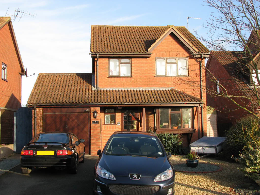

PThomas Posted July 23, 2007 Share Posted July 23, 2007 I am looking for a camera for home use, needs to monitor drive and caravan/cars. I have a street light just accross the road (Single lane road in cul-de-sac) as well as PIR activated floodlight and dusk till dawn low-energy lights. Can somebody recommend me a camera suitable to cover this area, primarily where the caravan will be located whn it is not in secure storage. Ideally manual variable lens so I can select the best coverage and minimum 420 lines resolution (ideally 480-520 lines). I presume that with the existing lights I don't need a IR camera? Budget for camera is approx Link to comment https://www.thesecurityinstaller.co.uk/community/topic/20027--/ Share on other sites More sharing options...

PThomas Posted July 23, 2007 Author Share Posted July 23, 2007 I have a photo taken from the scafolding showing the area I want to cover, the EXIF information from the top photo shows a focal length of 6mm - does this equate to the same thing on CCTV cameras? Link to comment https://www.thesecurityinstaller.co.uk/community/topic/20027--/#findComment-173060 Share on other sites More sharing options...
