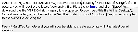

Guest rjbsec Posted July 8, 2006 Share Posted July 8, 2006 www.gardtec.co.uk > Downloads > Remote Scroll down until you see:- Click on the link. Personally I don't find it the most user friendly software. Link to comment https://www.thesecurityinstaller.co.uk/community/topic/11269-control-panel-and-remote-monitoring/#findComment-106265 Share on other sites More sharing options...
