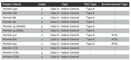

Guest digi Posted April 4, 2006 Share Posted April 4, 2006 Hello thank you for taking the time to look at my post i wanted to know does the "TEXECOM PREMIER 816" comply to all regulations for monitored systems? Link to comment https://www.thesecurityinstaller.co.uk/community/topic/10085-texecom-premier-816-does-it-comply/ Share on other sites More sharing options...
j.paul Posted April 4, 2006 Share Posted April 4, 2006 Hello thank you for taking the time to look at my post i wanted to know does the "TEXECOM PREMIER 816" comply to all regulations for monitored systems? The Premier 816 is a grade 2 panel with a ATS2, so can be used on grade 2 a,b,and c (with extra ATS) There are no stupid questions, but there are a LOT of inquisitive idiots. Link to comment https://www.thesecurityinstaller.co.uk/community/topic/10085-texecom-premier-816-does-it-comply/#findComment-94114 Share on other sites More sharing options...
Guest digi Posted April 4, 2006 Share Posted April 4, 2006 Metal end station version is Grade 3... thanks alot Link to comment https://www.thesecurityinstaller.co.uk/community/topic/10085-texecom-premier-816-does-it-comply/#findComment-94118 Share on other sites More sharing options...
j.paul Posted April 4, 2006 Share Posted April 4, 2006 Metal end station version is Grade 3... There are no stupid questions, but there are a LOT of inquisitive idiots. Link to comment https://www.thesecurityinstaller.co.uk/community/topic/10085-texecom-premier-816-does-it-comply/#findComment-94121 Share on other sites More sharing options...
morph Posted April 4, 2006 Share Posted April 4, 2006 Hello thank you for taking the time to look at my post i wanted to know does the "TEXECOM PREMIER 816" comply to all regulations for monitored systems? As the others have said and also depends on where you buy the item and if it is new with the current software version. Link to comment https://www.thesecurityinstaller.co.uk/community/topic/10085-texecom-premier-816-does-it-comply/#findComment-94123 Share on other sites More sharing options...
