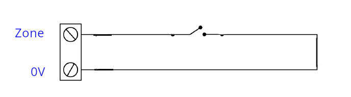

I've done several trials, and here's what I've found. I wired as per the picture below... And configured the zone as 0ohm N/C and the chime now works when the door is opened. So, it might be working, I am not sure? This config is the only trial that resulted in the chime when the door is opened.

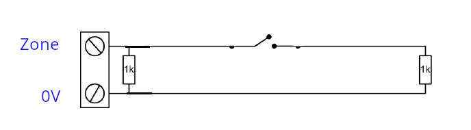

Thanks for the update. Yes, you are absolutely correct. Gaining access to the reed switches isn't an option right now (future plans to replace), so the best I can come up with might be below... Or I could use the wiring below... Obviously neither is ideal... but for now perhaps the only option?

Hi Stuart. The picture below is how I have configured the PIR's as per sixwheeledbeast advised in an earlier post. So to confirm, are you saying to leave as the default 'double balanced 1k/1k' for the PIR's? Just an FYI, the PIR's appear to be working. The reed switches on the doors and windows appear not to be working. The wiring of the doors are a reed switch per door, and a 1k resistor at the 0V end. Picture below... Below picture shows the area I have been tweaking the config... but haven't found a solution yet. Any suggestions on zone config or resistance greatly appreciated.
