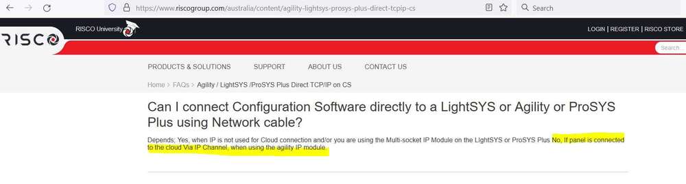

  2. For anyone else's benefit , think we have the final answer to why the Configuration Software will not connect. Below from the Risco FAQ section. Seems if the panel is connected to the Risco cloud via the IP channel ( and our panel is, with valid subscription ), the the Configuration Software cannot connect to the panel. Sort of reluctant to test / confirm this by disconnecting the panel from the Risco Cloud in case Risco then say " you can't reconnect , you are an end user etc etc"
