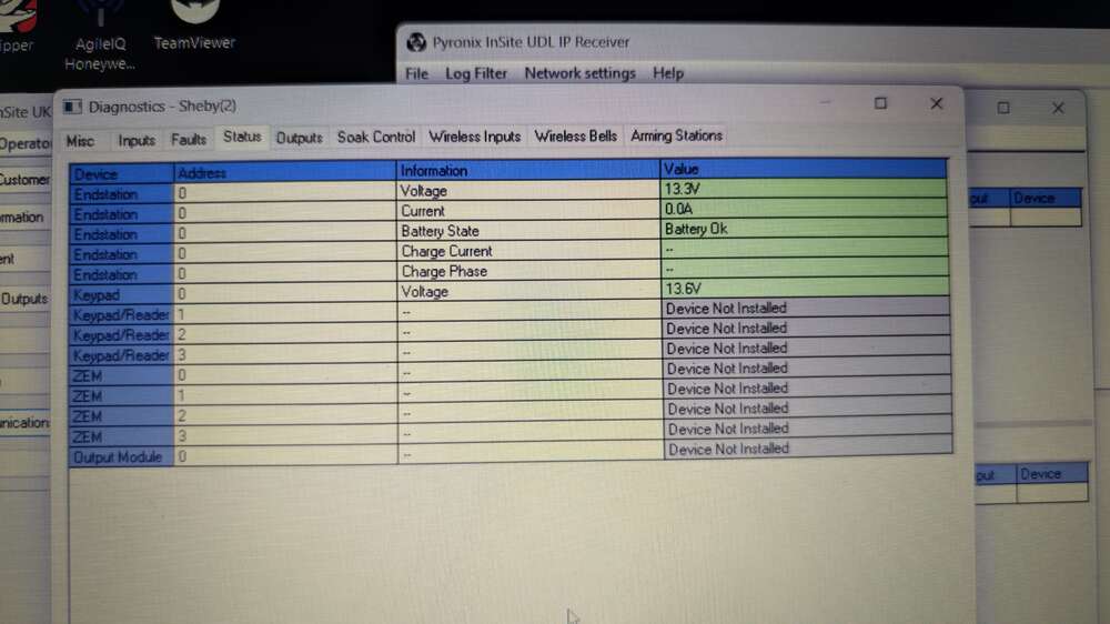

  2. So supervision faults pop up here and there like the bell and the farthest away pir but then clear again, I changed the timer to 250 and reset but still not staying clear, the current is 0.0A, see picture attached for details

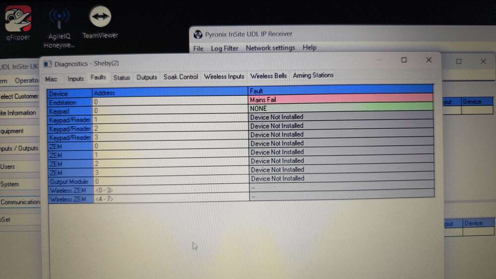

  3. Here's what the panel sees, I still need to find the time to get out and check the supply myself again after the new spur has been installed

  5. 1, goes from a spur to a built in step down/PSU to 13-15v, checked voltage on it and gives out correct voltage

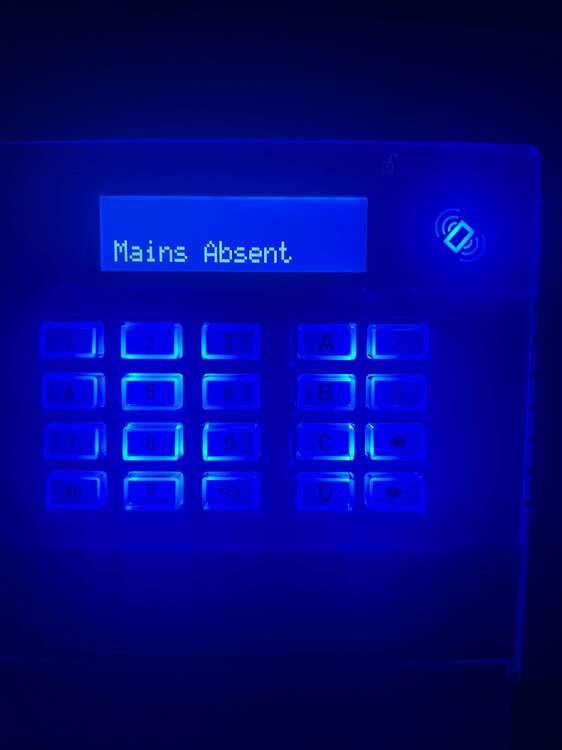

  7. Yes just an enforcer, I did say this to the client but his "electrician" said it's fine can't find a mains fault delay on these panels at all, if there was a way of turning off the fault monitoring I would but going to guess unless soldering is required I'm gubbed.

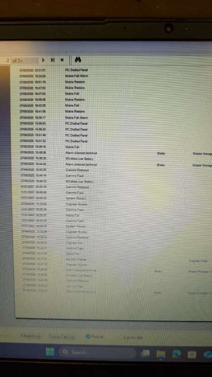

  8. Yeah he said he got an electrician out to fit a direct new spur next to panel and same issue, told me he put his meter on it at the spur and it read 240v but thought he'd have at least done more tests whilst he was there. No log for old one no, just this one but it's about the same frequency so keeps dropping off and restoring, thought maybe a dodgy spark had tapped off of a light switch and when the switch was flicked it was dropping power to the panel then turning it on again restored power but the new spur disproves that.

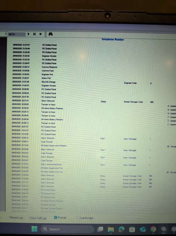

  9. Shows this, at the time I was away the client said that the panel showed mains absent but wasn't on the log until later when he turned the spur off to test, but it's not there at all

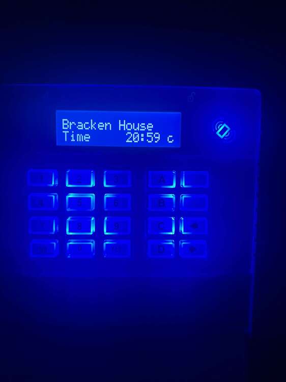

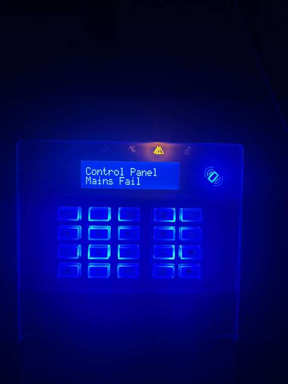

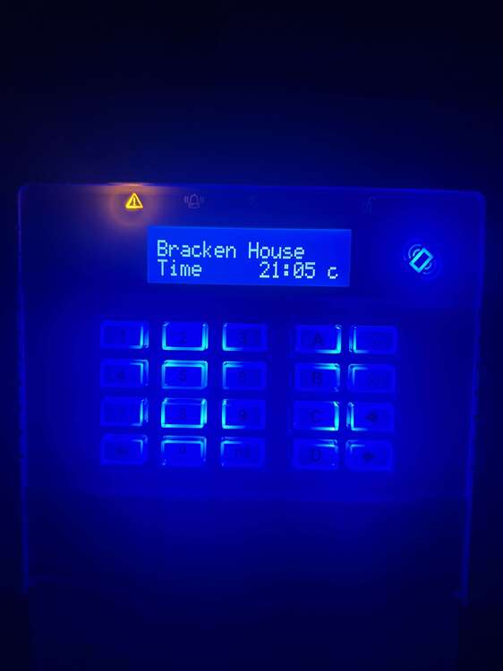

  10. Hi, I don't tend to ask for help on anything fire/security but find myself stuck, I have a pyronix Enforcer panel and it keeps getting a mains absent fault with the first warning light on top of the panel. Then it has shown a control panel - mains fail fault with the 4th light on at the top, I have replaced the panel but still same issue, client got a spark out to run a new cable from the board next to the panel and put in a new spur, checked voltage and power to system, I also checked voltages when there and no drop, 240v at mains/spur side and 13-15v at Stepdown for panel side, anybody ever had this issue? Need this sorted ASAP and it's doing my head in now. Any help would be appreciated, thanks.
