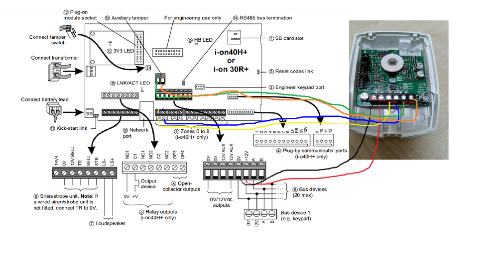

  1. @sixwheeledbeast thank you. I will install without it.
