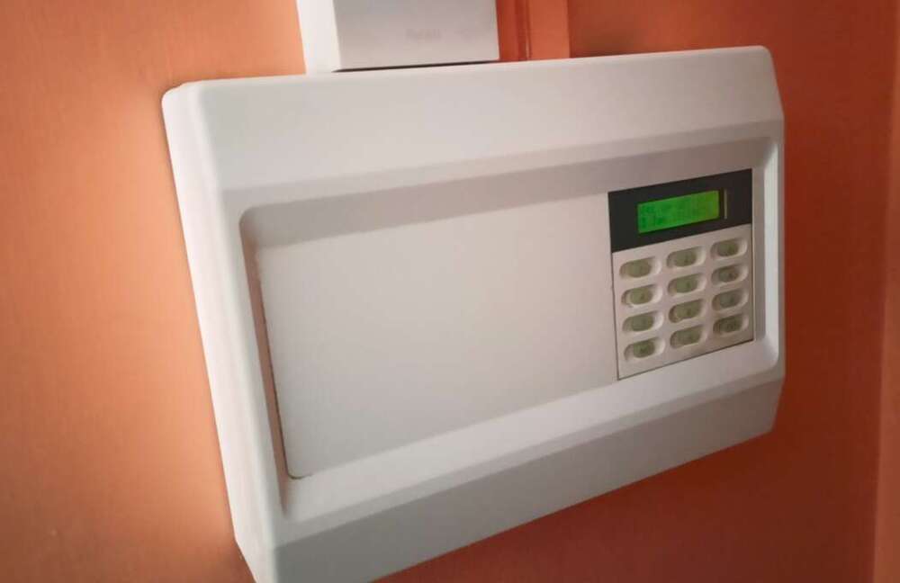

  1. Whats wrong with Terracotta paint!! ? Anyway I've fixed it! I would like to tell you I read the manual and trouble shooting guide and got all technical with it and found the problem but that would of course be a lie. I noticed it was saying something about Zone 6 12hr when the alarm went off so I figured I would turn zone 6 off which just happens to be the old back door sensor which is now kaput anyway. However when you go through the menu to turn off the zones it just does a kind of family fortunes XX buzz and says you cannot disable that zone. So I try that with the other five zones and the same. So then I reset the alarm and hey presto its fine. Tested it a couple of times and its ok. I worked in IT for decades and I never really liked it when stuff just fixed itself or got fixed and you are never really sure how. Jury is out. If it plays up again ill call in an alarm company. Cheers
  2. Thanks for the replies. The battery was replaced two years ago. Ill see if I can check what comes up on the panel later. As said, it was doing this from time to time before the recent power cut.
  3. This is the alarm. I replaced the battery a couple of years ago. Had a look round the sensors. They seem clean enough. There was a door sensor on the rear doors but when the doors were replaced it got broke and its just sat on the floor now coiled up in the corner. I wonder if it could be related to that. That was some time ago though and its been fine the last couple of years or so since the doors were done until recently.
  4. Hello. Don't know if this is in the right section, Just joined the forum. I have what I think is a Gardtec 800 series alarm. Its been here since we moved here 22 years ago so obviously quite old. Lately its been playing up where you set the alarm. Go upstairs to bed and 30 seconds later instead of hearing the beep of it being set the alarm goes off instead. We had a power cut the other day and since then its been happening all the time but Im pretty sure it was happening on occasion before that. Any ideas or do I need to call in a professional? Happy to do that but just thought it might be something simple.
