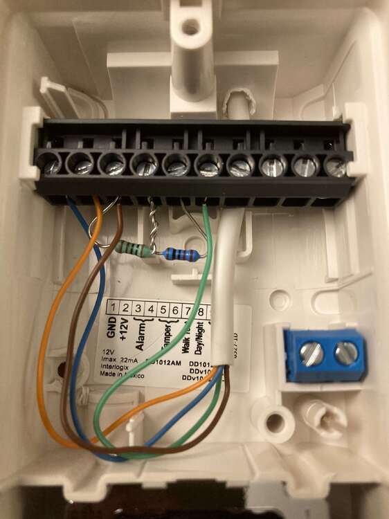

  8. Here is a pic how I wired PIR 1003 up. Blue= Ground, Orange= 12V Brown= alarm Green= tamper
  9. the picture above is the old wiring, and the film showing the new. Where would I place the resistor then to place it in the right place. :0)

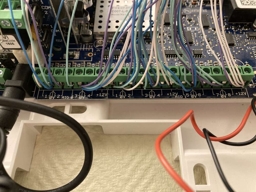

  10. I will attach a short movie on what the display says and a pic on how it looked before I took the old cables away. I put the 1k resistor between 1002 and 0V to the left of 1002. On the film it says (in Swedish): 1003 +SAB.Open circuit IR store floor 1002 +SAB.Short circuit IR store office Not beging an alarm technician guy I just guess that 1001 (that's a door magnet) would have 1=white and 0V=Blue and the 1002 that's an PIR would be connected with 2=purple 0V=green and blue and then the white to 12V on pin 7. IMG_1265.MOV
  11. Did put a 1K between 1002 and 0V but still getting the +SAB fault code on 1002 and did nothing, also got the same code on 1003 but I got all the cables in the right places gonna try a Wago clip just to see if its the cables that's not connected properly. No one out there that could help me via PM on how to reset this system of mine?
