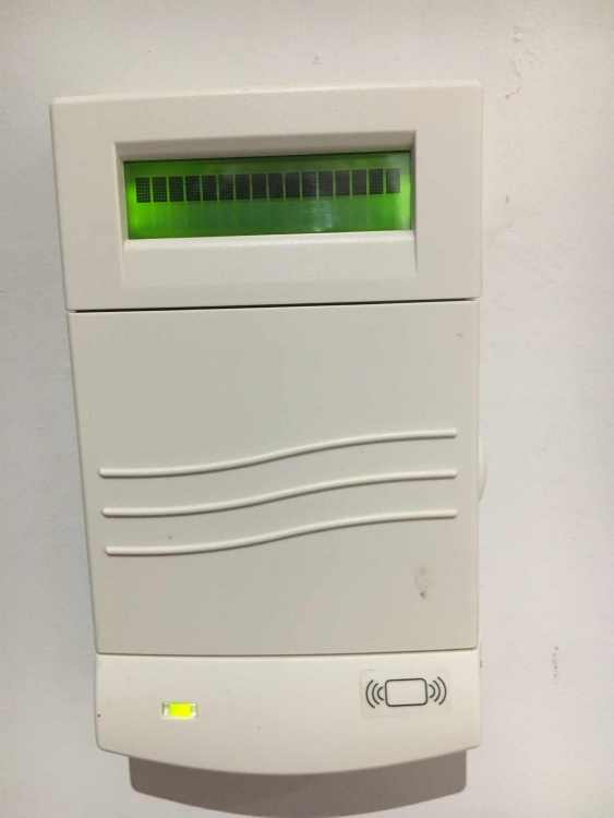

  1. When you say the plug on block, what are you referring to? Thanks
