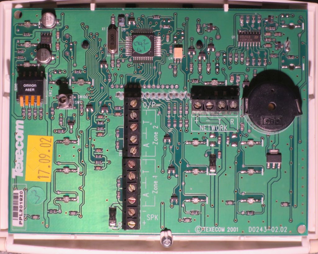

  2. This is a follow on question from http://www.thesecurityinstaller.co.uk/community/topic/41730-replacing-texecom-key-pad/ which contains some pictures of my current alarm system. Thanks for the advice on fitting the replacement key pad which is working fine. The new key pad had a wireless PROX keyfob symbol and I thought these would be better than typing in the code so I bought some Texecom Elite Keyfobs of ebay. However when I tried to program one I discovered that the menu option is missing so I presume this functionality is in the box rather than the key panel. What is my best option for getting the key fob functionality working? Can I upgrade the firmware in the main box to make it compatible or is to too old and I need to purchase a new master box? If it’s a case of new firmware where can I get a copy from and are there any instructions for installing it? Will the current settings remain after the upgrade or will I need to reprogram the system? If I need to buy a new box which one is going to be the best match for my current box? As far as I can tell the box is a Premier 412/816 running the V6 software based on the fact the manual is INS159-5 and it came with an additional loose sheet for the version 6 software.
  3. Picture of current keypad (slightly yellow) and keypad of potential new keypad and PCB of potential new keypad.
  4. pictures of board and keypad PCBs and style of outside of control box.
