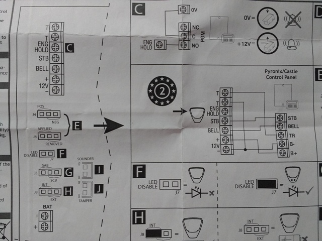

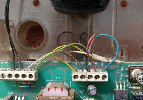

  7. I am in the process of replacing my external Bellbox which is connected to a Securit 700L Control panel, the system was installed when the property was built around 1996-7, there is no name on the Bellbox except the flaking writing with the Installers name & phone number. Amazingly I still have the original Engineer instructions (with all codes) and it all still works after having replaced the Battery in the control panel, I then decided to check the Battery in the Bellbox thinking that was also due to be replaced, on removing the Bellbox cover I could see that one of the Battery wires was not even connected and just dangling loose and I suppose it was never connected during installation but has never caused a problem. So after a bit of research I purchased a Pyronix Deltabelle plus Bellbox and I need some help with the wiring, I have cross referenced some of the wires but not all of them, bellow is what I have with some images of all components to help you help me. This is my current set-up Securit 700L Control Panel External Bellbox And this is the Installation diagram for the Pyronix Deltabell Plus My understanding from this is as follows, could you please confirm and fill in the gaps. Deltabell Bellbox Securit 700L Control Panel T (1st T) = Tamper Return (Yellow) R- (Bell Tamper return) T(2nd T) = Tamper Negative feed applied and - (Bell Hold Off Neg supply & Bell Tamper) linked to Negative in Bellbox (Black)?? Eng Hold = ???? ??????????? STB = Strobe Trigger (Green) ST- (Strobe switched Negative trigger) Bell = Bell Trigger (Blue) S- (Bell switched Negative trigger) 12v + = Positive Hold Off (White) + (Bell Hold Off/ Strobe Positive Supply) 12v - = Negative Hold Off (Black) - (Bell Hold Off Neg supply & Bell Tamper) ?????????????? (RED) + (Bell Hold Off/ Strobe Positive Supply) On my existing Bellbox I have a terminal E looped with a Black wire to A- which is connected to Bell Hold Off Neg supply & Bell Tamper in the Control panel, is this E the old style Engineers Hold Off? The Deltabell has Eng Hold terminal, where should I connect this to in the Control panel? Any help at all would be appreciated, thanks in advance. If you need any more info or images please let me know. Thanks.
