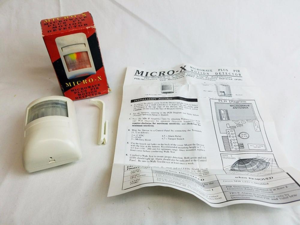

  2. No there is no lid fixing screw ! There is a special tool to release cover ifs against celing, like one in pic ....
  3. You Deffo have to remove the small pcb screw to fit it to a wall. Installation Instructions 1. Open the housing by removing the front cover. To do so, press the tab located on top of the detector. 2. Remove the PCB by unscrewing the PCB screw from the rear of the protective plastic casing. Note: Do not touch the face of the PYRO sensor.

  7. Remove the small screw on the pcb and pull board away and fix the the rear of the housing to the surface and re attatch
  8. No I don't think so, and I think it is the micro x line from looking at PDF online.

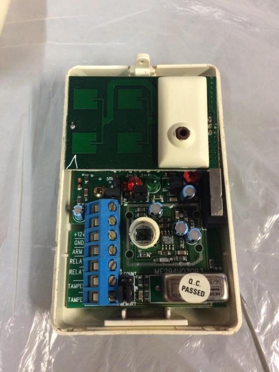

  9. Well the workshop has been extended/built which cost quite a bit so I've used existing old alarm which was out of use got back up and running with new battery etc (optima xm6)....and moved into new side of workshop. It has quite a lot of kit in and has a lot of value I was just trying not to overspend for the sake of it, so next idea for a sensor lol .I'm going to get a full pic of old sensor now.
  10. It's back in the work shop as soon as I'm back in there tomorrow I will do.
  11. Thanks all to the replies after leaving the system disconnected and re connecting after 24 hrs it seemed to have cured itself, I may still wire in a new pir sensor as lots of comments saying it old and could be past it's used by date. Just randomly put the jumpers in any position. Any recommendations on a new sensor not looking to spend the Earth. https://www.toolstation.com/shop/p34020?table=no
