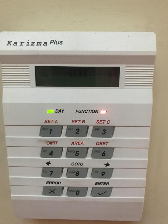

  1. Yes there is 2 Psu's 1 in the panel & another above
  2. Ok Great thanks I think I'm going to swap this out with a Gardtec/ Risco Group 595 panel or sonething that I am familiar with ! i seen people talking about the Karizma Plus panels the door contacts and Shock sensors possibly having biscuit ID how do I check if this is the case ? I will I'll try the keypad that you say there is about 30 shock sensors, 10 door contacts and a few PIRs and 4 RKPs and 1 bellbox
  3. Hello I have reset a panel which has been down for around 1 month after the panel went off in the middle of the night and the fuses and battery was removed I have tried to default the panel to factory settings and after doing so the screen has come up strange on keypad 1 there is 4 keypads on this panel before defaulting we were not able to do anything at the keypads some said System Init and the others said System Busy and would not clear even with a manager code Any ideas what to do from here I'm thinking possibly the panel is knackered and I should change this just before I do I would like to get some simple advise do you think there has possibly been a power surge which has damaged the panel ?

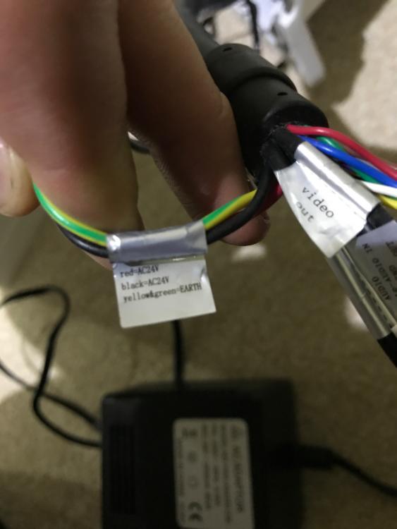

  4. Checked the transformer it's 27.3 volts output giving on multi meter any ideas ?
  5. Yes that's me
  6. I thought the negative was missing however its AC24V?

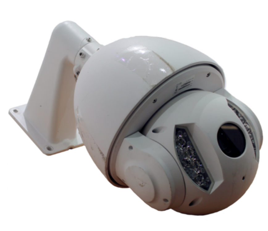

  7. I tried this and it didn't seem to work the IR's on the dome did not light up i have covered up the photocell on the dome however it didn't light up Any ideas? I thought possibly the RED & BLACK if they are AC24V pay both be positive and the other earth may be the earth/ negative on the twin core? Thanks for your response, i am TRADE- JDB Solutions in Glasgow I tried this and it didn't seem to work the IR's on the dome did not light up i have covered up the photocell on the dome however it didn't light up Any ideas? I thought possibly the RED & BLACK if they are AC24V pay both be positive and the other earth may be the earth/ negative on the twin core? Image attached of actual camera.
  8. See image here i have the following on the power supply: red= AC24V black= AC24V yellow&green= earth On my power supply it is PTZ 3.0 Amp 24V Supply I have a black 2 core cable from the transformer so do i just connect these to the red and black or has the red and black to go together and then the earth on the other core of the transformer? it isnt very clear so i just want to be sure? I look forward to hearing from you soon! Thanks Jack

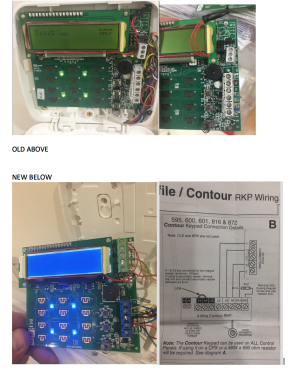

  12. See attached i have an old KEYPAD on a Gardtec 595 Panel the screen has went, i have tried to swap it out with this new 4 Wire Blue LCD Keypad however it does not work does anyone know a way of getting it to work with resistors or do i need to send this back to Risco Group and get a 6 Wire Version? If i need to send back and get a 6 Wire Version does anyone know if it is available in Blue LCD? Thanks Jack Buchan JDB Solutions
