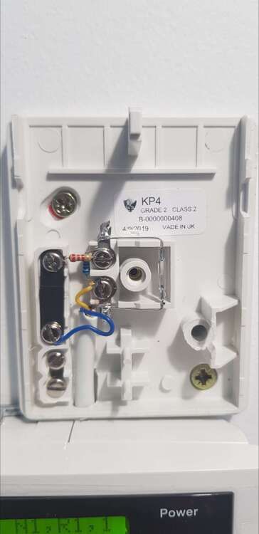

	Ah I've been looping the conductor around the screw and clamping the screw down on top of it, almost turning the conductor itself into a ring crimp if you get me? Good take away that about looping round then trimming, cheers. I've give the cover a few taps/ pushes/ pulls and triggered/ reset the button itself a few times and it seems to be behaving, so maybe it was just a case of loose terminations and biting into the conductor a bit too much tightening the first time, it's only been the leaf tamper/ open screw terminal/ wraparound screw terminals I've had any issues with - I wish lever connectors were more commonly installed in everything!
	They do look a bit rough admittedly, I was using a terminal driver that probably was too small for the job on the terminals, re-tightened with a better, broader flathead though. I gave them a bit of a twist to make sure they stayed in form as they went around the screw but nothing too savage, I did consider ring crimping but I think they'd have been too big to fit between the terminals, or at least interfere with the cover fitting/ tamper leaf clearances, and the cores are that small the crimps could've just added to the problem. Been sat at 2.19k for the past few hours now so see what happens in a few days time...!
	Not really much else place to put it since the keypad is essentially "boxed in" by CH pipes and LV cabling, any other location would've put it too close to LV cabling or put it straight across CH pipework unfortunately, but yeah it will be a pain to get the RKP off, didn't think of that! Fingers crossed that doesn't start playing up. Had a ratch around on the connections and it looks like one of the cable cores was a little shredded where I'd tightened it down too much, remade it off and checked the other terminations, see what happens. If it goes again I'll go the double pole route I think, got enough play in the cable. I metered across each termination and the resistances seemed stable, but I take the point about the potential for damaging the ceramic. One thing I noticed was some of the magnetic material had come loose from the mount on the PA button shaft, I do wonder if enough of that flapping about could have caused the reed to mooch around a bit. I did notice when tightening down there was almost an inverse bell curve between resistance and tightness, too loose and the resistance was high (obviously), just about finger tight and the resistance was spot on, another quarter turn and it started going up towards 3k/4k again. Cheers for the input! Easier actuation than pulling down the keypad cover and aiming for numbers, generally more recognisable function/ device and easier to operate when unfamiliar with the system. Same reason emergency stops are a thing.
	3 zones needing a revisit on a freshly wired and installed Premier Elite 48 isn't that bad is it! :^) The JB (added a bit more to the tamper actuator) and first PA (tightening the cover a bit more) seems to be fine now to be honest, just that remaining pesky PA that I'm hoping will be resolved by a bit of tightening up.
	I normally burn a few resistors to keep away the spirits too...
	I'll take the cover off the PA that recently activated and give everything a retighten and check (and make sure the cover is tightened down proper) but yeah I think if it fails soak I'll put in a G3 microswitched replacement instead.
	I'm beginning to think the leaf tampered stuff is more trouble than it's worth definitely... The two products are the Knight KP4 G2 Double Push PA button and Knight 8 - Way Junction Box. The Knight KP4 is wall mounted in a hallway, nowhere near any EM fields that could interfere with the reed, not in sunlight or above a heater or anything but it drops a few degrees at night, had one random activation where it went up to 4k and wavered for a bit between 3k/4k and then settled back down to 2k, but I did notice when installing if you don't screw them down tight enough the tamper resistance can slowly drift/ creep. The Knight JB mounted at high level in a garage, again nowhere near any EM fields that could induce EMF, not in sunlight etc. but the timing of the fault coincided with when the sun would start heating the garage up (again a few degrees, nothing huge). Same case of random activation(s) where it'd go up to 4k but this happened a few times. Took off the cover, cut a bit more out of the JB where a small grommit entered just in case this was expanding and pushing the cover up a bit, added a bit more to the tamper actuator so it had more travel, this seems to have done the job and not had any more issues for X weeks now. The timing might just be coincidence in terms of temperature fluctuations but not really any clue on anything else that could've caused it, the rest of the installation (around 20 other wired FSL zones) is rock solid and the cabling itself tests fine. I have a few more of the same products installed elsewhere on the property and had zero issues with them.
	I've recently had three separate issues where the leaf tampers (two on PA buttons and one on a small junction box) ended up causing wavering resistances (2k2/4k7 system reporting 4k0 or 9k0 resistances randomly) and caused tamper/ intruder alarms. I've tried everything possible to ensure terminations are secure and tight, conductors are making good contact with the terminals and the covers of the components are screwed down tight (not loose, not over tightened), in one case I resorted to adding a little more length onto the tamper leg to ensure it has good contact on the leaf which seems to have worked (and the tamper still functions as required). The only correlation I can see is that each fault occurred when the building was warming up/ cooling down; am I doing something wrong here? Could temperature changes cause these issues? Never had this problem with microswitch tampers that I can recall so I would like to think it's not my s**t wiring.
