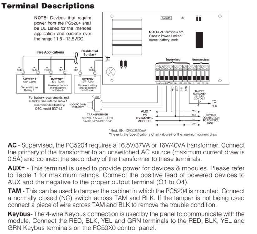

Everything posted by privatesam
  1. Interesting but there's no reference to resistors in the manual and to be honest I'm not trying to monitor for faults on trigger or anything - I'm simply looking to see if I can activate the sounder. I have even tried simply touching the trigger wire at the panel end on to the aux - just to try and activate the sounder but nothing.
  2. I've use my multimeter on DC and popped the positive on the hold off + and the negative on the bell trigger and it registers as >12v with or without the system in alarm. Could this be indicative of something? (thanks for your reply btw)
