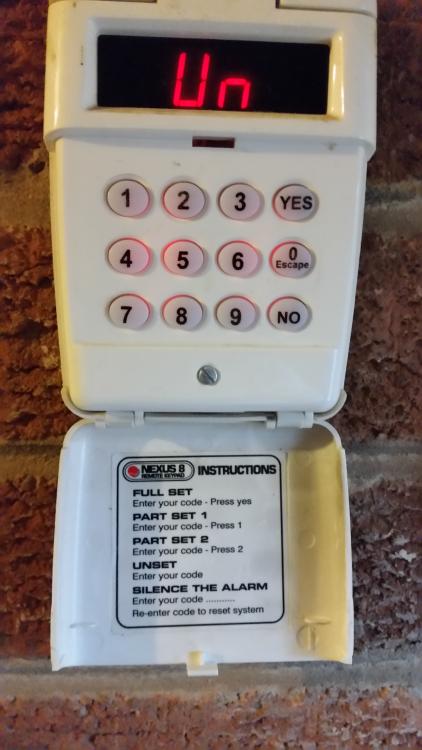

  3. Yes I think it is Lyntech and I emailed them but got no reply. I think I will tell my son that it may be better to change the the lot. for the replies.
