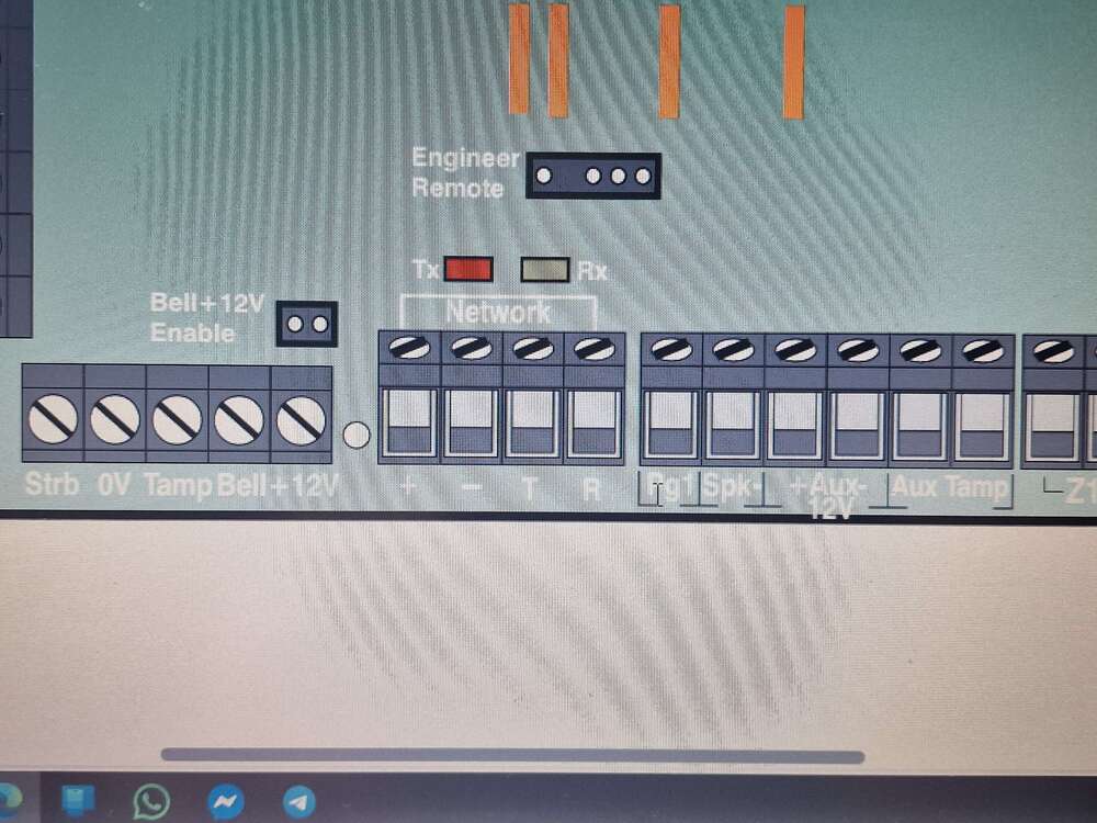

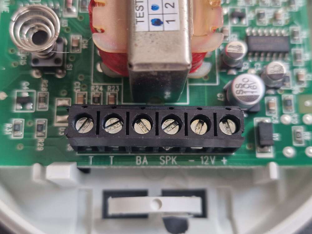

	Texecom Premier Extension Speaker Wiring.Dave Walton replied to Dave Walton's topic in !!..DIY Installers..!! Thank you. (I don't have the wiring instructions, this kit came to me as previously used)
	Good evening all. Requesting a little help from the good folk of the security installer. I have a pair of Pyronix internal twin alert speaker / sounder units that I'd like to wire into the above mentioned Texecom Premier 24 control panel. I've attached a couple of pictures showing both the speaker / sounder connections and the control panel connections. If some kind person would kindly give me the correct wiring connections between the two it'd be much appreciated. Thank you and regards, Dave.

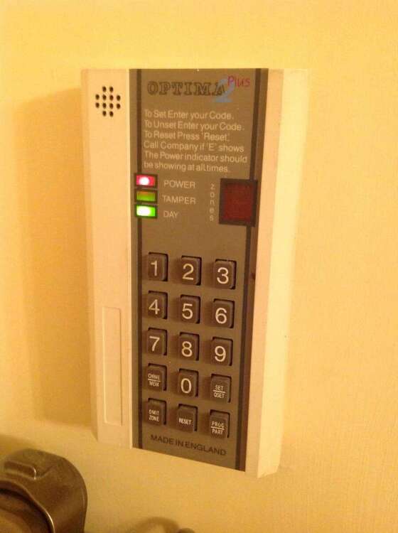

	Evening all. I have a very old but very reliable ADE Optima 2 Plus 8 zone alarm system that I installed some 30+ years ago. Problem is I would now like to add another keypad to the system (Two fitted at present) and the chances of me getting my hands on one is more or less zero ! (Already looked on Ebay, etc) So, two questions for the good folk on here, first the long shot.......Does anyone by any chance have a Optima 2 plus keypad lurking somewhere in the depths of their van, garage, loft, etc, etc, that they'd like to sell me ?, and two, is there an alternative keypad that I could use on this system, and if so, which one is it ? FYI.....I've attached an image of the type of keypad in question, the connections on the keypad are as follows K1 - K2 (Tamper) K3 - K4 (- & +) K5 - K6 (Data) If anyone on here could help me out, it would be very much appreciated. Regards, Dave Walton.

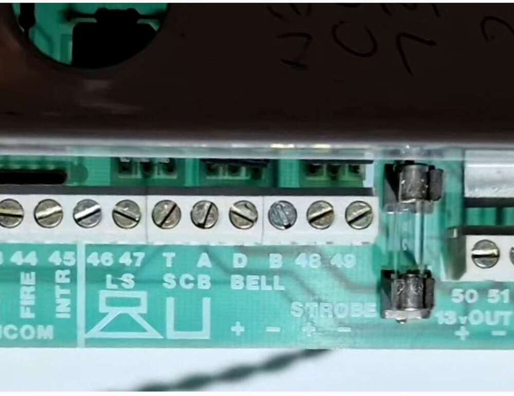

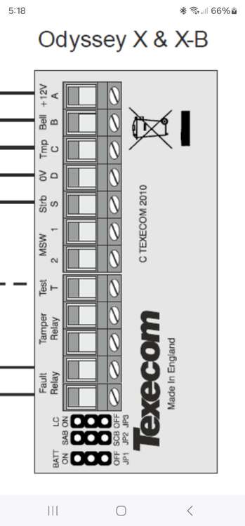

	Good evening all. Looking for some help regarding wiring a Texecom Odyssey XB-E bellbox into a very old but working perfectly ADE Optima 2 Plus control panel. Been something like 30 years since I ventured up the ladder to fit the original Flashguard bellbox which has recently failed. I've sourced the aforementioned Texecom bellbox as a replacement and would much appreciate the kind folk on here confirming what I think to be the correct connections between the two as this would hopefully help me avoid making any more than one trip up the ladder to complete the job. (Several trips up the ladder result in much aching of my, these days, not so young legs !) I've included a diagram of the terminals at the bellbox and a picture of the terminals at the control panel. Your help / advice with this small issue would be very much appreciated. Regards, Dave Walton.
