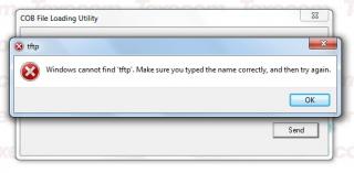

  2. I had done that but still did not work. Anyways, then I installed it through dos prompt was was quite simple. The problems is that the code is still not working as per above post. Any ideas?
  3. I opted for DOS: tftp -i xxx.xxx.xxx.xxx PUT Web1.cob WEB1 which worked. In fact I can now see the Menu on the side. I enter the engineering password. When I click Online Keypad, I get the keypad indicating "Reading.......", then I get no "Access with System". Then I click something else such as System Zone Status or Event Log and I get a System Alerts on the keypad - Areas need reset and Com 1 Fault. Trid this a number of times and always get the same issue. Do I need to enable something?

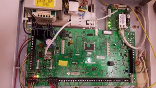

  10. I have the Com-Ip module attached to a premier 48. When I query the ip address from a web browser, I get a nice diagram and the following wording: [b]For web page examples please click here. For more information on web page applications, please contact your installation company or distributor. For information on all Texecom products please visit: www.texe.com.[/b] I tried to look in the provided CD but there is nothing in there. Anything you can share or how do you suggest to go about? I tried to contact my supplier but did not receive any reply so far (been a few weeks). Thanks
