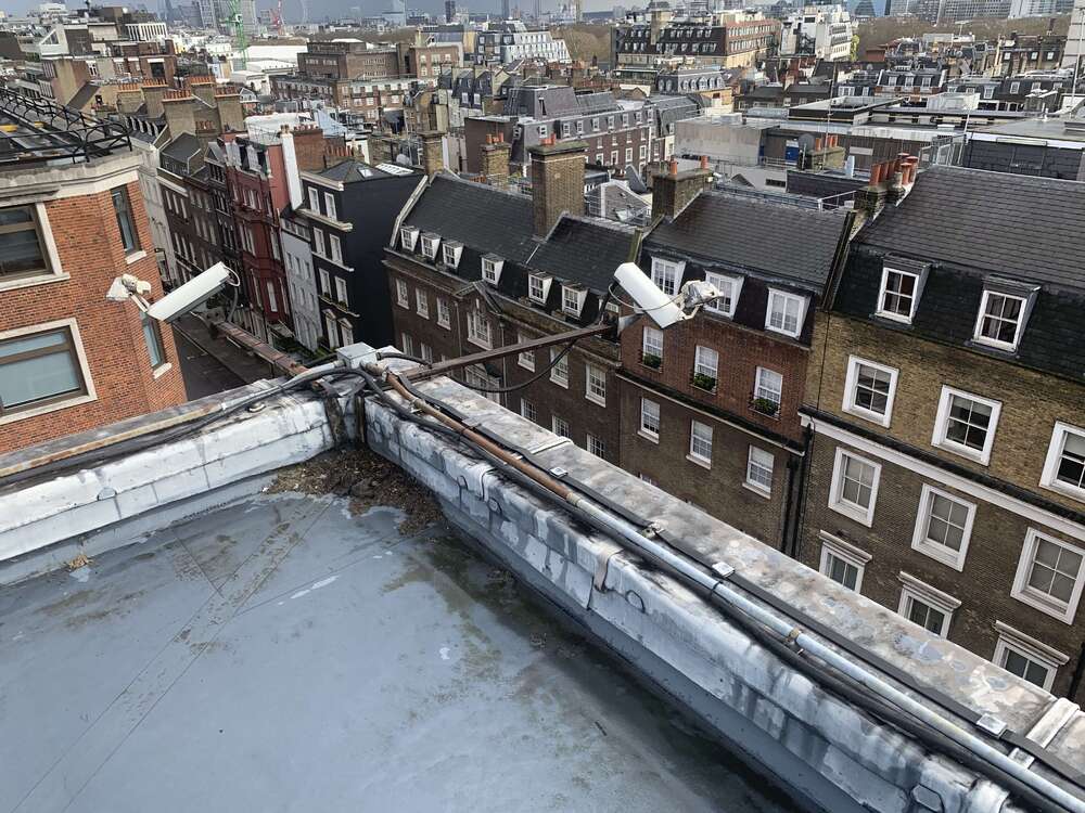

  8. There is a balcony just below it, yes it is an analogue dvr.
    I’m assuming I can’t just swap it for something like a hik or dahua and axis would be too high spec, maybe I need to have a look through the Alien website to see what they offer.
    i think these are called body or box cameras, if so are they a standard fit in the existing housing or would this be a new housing?
    thanks
  9. Hi
    i have a client who has a Alien Mega Hero Dvr, it’s running some external 230v cameras with a floodlight mounted above the camera (see picture attached)
    one of the cameras is faulty and I need to propose a suitable replacement, I’ve attempted to contact Alien but no answer, I was going to call them on Monday but thought I’d ask on here first
    Thanks
