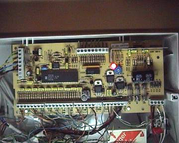

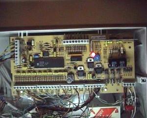

Guest Nigel Tuohy Posted February 27, 2005 Share Posted February 27, 2005 Here is the Photo of the circuit board Link to comment https://www.thesecurityinstaller.co.uk/community/topic/5203-changing-zone-type/#findComment-41870 Share on other sites More sharing options...
morph Posted February 27, 2005 Share Posted February 27, 2005 You do have the wrong manual. Did you do this: Prog Engineer Code. press 6 - zone indicators 1to8 flash momentarilly, then show current flag status. press 6 press reset 3 times. Job Done. Link to comment https://www.thesecurityinstaller.co.uk/community/topic/5203-changing-zone-type/#findComment-41871 Share on other sites More sharing options...
