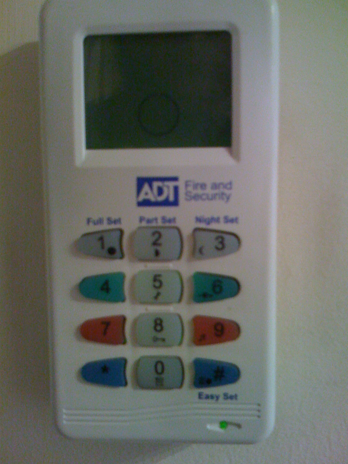

cwpaters Posted May 27, 2009 Share Posted May 27, 2009 Hi, I am a newbie to this board but have a little problem (picture of alarm keypad attached) I dont know the make and model of my ADT alarm and dont have a copy of the manual! i have been through all the online manuals on the ADT website with no success!! Can anyone identify the alarm? or have a manual for me? I am having an ocasional problem well a little more than not with the alarm sign on the lcd flashing all the time!! i sued to be able to put in my code and it would stop flashing? but sometimes it down not work and it means i canot set my alarm? have tried on my night setting and it the triggers ets self!! and i dont know how to reset it? can anyone please help? thanks in advance colin Link to comment https://www.thesecurityinstaller.co.uk/community/topic/28853-adt-alarm/ Share on other sites More sharing options...
aismoresecur Posted May 27, 2009 Share Posted May 27, 2009 Its an accord XPC, these are now obsolete. Dont have a user guide to hand but i'm sure someone on here will. Link to comment https://www.thesecurityinstaller.co.uk/community/topic/28853-adt-alarm/#findComment-238654 Share on other sites More sharing options...
aismoresecur Posted May 27, 2009 Share Posted May 27, 2009 I'm sure zone 9 tamp = panel cover. make sure the tamper spring on the main pcb is fully depressed. Not allowed programming manuals on the public forums mate Link to comment https://www.thesecurityinstaller.co.uk/community/topic/28853-adt-alarm/#findComment-238656 Share on other sites More sharing options...

cwpaters Posted May 28, 2009 Author Share Posted May 28, 2009 Sounds like the unit has currupted,where abouts are you as I have a bit of knowledge of these sorry about uploading the links!!! i am in aberdeen m8 last night i pressed a few buttons and set the alarm off and this has now seemed to have reset it! prob will come back though!! Link to comment https://www.thesecurityinstaller.co.uk/community/topic/28853-adt-alarm/#findComment-238731 Share on other sites More sharing options...
