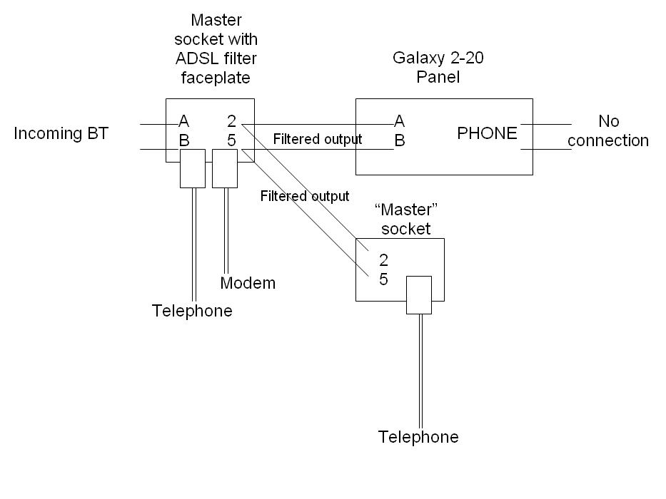

Guest anguscanplay Posted September 18, 2007 Share Posted September 18, 2007 you dont have to worry about wiring the second phone into the galaxy - just connect them all to 2 and 5 in the back of the BT faceplate Link to comment https://www.thesecurityinstaller.co.uk/community/topic/20743-galaxy-2-20-adsl/page/3/#findComment-178667 Share on other sites More sharing options...
simonw Posted September 18, 2007 Author Share Posted September 18, 2007 you dont have to worry about wiring the second phone into the galaxy - just connect them all to 2 and 5 in the back of the BT faceplate amateurandy - I was hoping to have the option of using the "real" master socket with the filter faceplate for both phone and modem connections. Is there a problem with using a phone in the master socket? Anguscanplay - Do you mean like the attached? Is this a better (because it's simpler) option? anyone - I haven't installed a seize unit anywhere and I don't know whether one is included as an integral part of the standard Galaxy 2-20 panel. Is this likely to be an issue? Link to comment https://www.thesecurityinstaller.co.uk/community/topic/20743-galaxy-2-20-adsl/page/3/#findComment-178690 Share on other sites More sharing options...
amateurandy Posted September 18, 2007 Share Posted September 18, 2007 amateurandy - I was hoping to have the option of using the "real" master socket with the filter faceplate for both phone and modem connections. Is there a problem with using a phone in the master socket? No problem at all, unless you want to use a line seize unit, but you say you don't. Link to comment https://www.thesecurityinstaller.co.uk/community/topic/20743-galaxy-2-20-adsl/page/3/#findComment-178691 Share on other sites More sharing options...
Guest anguscanplay Posted September 18, 2007 Share Posted September 18, 2007 amateurandy - I was hoping to have the option of using the "real" master socket with the filter faceplate for both phone and modem connections. Is there a problem with using a phone in the master socket?Anguscanplay - Do you mean like the attached? Is this a better (because it's simpler) option? yep anyone - I haven't installed a seize unit anywhere and I don't know whether one is included as an integral part of the standard Galaxy 2-20 panel. Is this likely to be an issue? IMO ( legal discalimer - lol ) if you need a " line seize " unit you need more than a DIY install anyway - perhaps you could connect it to an ex directory incoming calls barred line ? ( ahh that takes me back to the days before redcare - lol ) let us know how you get on Angus Link to comment https://www.thesecurityinstaller.co.uk/community/topic/20743-galaxy-2-20-adsl/page/3/#findComment-178693 Share on other sites More sharing options...
simonw Posted September 18, 2007 Author Share Posted September 18, 2007 IMO ( legal discalimer - lol ) if you need a " line seize " unit you need more than a DIY install anyway - perhaps you could connect it to an ex directory incoming calls barred line ? ( ahh that takes me back to the days before redcare - lol )let us know how you get on Angus Well I guess that just about wraps it up then. I'll put Angus's suggested simplified wiring option in tomorrow and I'll forget all about the seize unit. It just remains for me to thank everyone for giving such kind help and advice - ! Simon Link to comment https://www.thesecurityinstaller.co.uk/community/topic/20743-galaxy-2-20-adsl/page/3/#findComment-178702 Share on other sites More sharing options...
