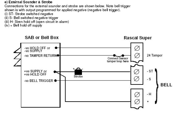

Guest Roger100 Posted December 3, 2006 Share Posted December 3, 2006 I have an old Rascal Super 29 alarm, the bell box stopped working and I have purchased a Reson8 replacement, how do I connect the new box? On the old box I connected 4 wires: Bell box Rascal -V Tamper +V Bell + SW- Bell S Ret- Tamper return The new bell box has the following connections STB- TRIG- HOLD OFF - HOLD OFF+ RTN- How do I connect the new box. Link to comment https://www.thesecurityinstaller.co.uk/community/topic/13871-reson8-bell-box/ Share on other sites More sharing options...
Guest rjbsec Posted December 3, 2006 Share Posted December 3, 2006 Link to comment https://www.thesecurityinstaller.co.uk/community/topic/13871-reson8-bell-box/#findComment-135400 Share on other sites More sharing options...
