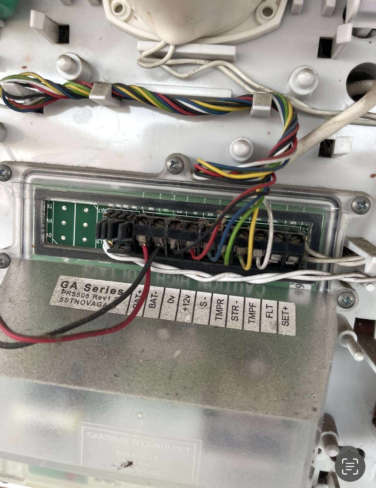

  4. Sorry, hectic weekend. I'm a little confused but I this is what I think needs to be done: 1. Remove the link (Black loop) in the panel between 0v and TR 2. Put a link in between 0v and tmpf in the sounder 3. The green can be left as is. Does that sound right? thx nate
  5. Ok, so remove the wire running from 0v to TR, but leave the white cable in TR? And Green to be left as it is? thank you!
  6. Sorry is it not wired correctly? Whats the correct wiring? is tmpf not correct?
  7. Not sure. Tbh. Managed to get to the sounder and took this pic of the internals. Green is terminated at TMPR at the sounder.

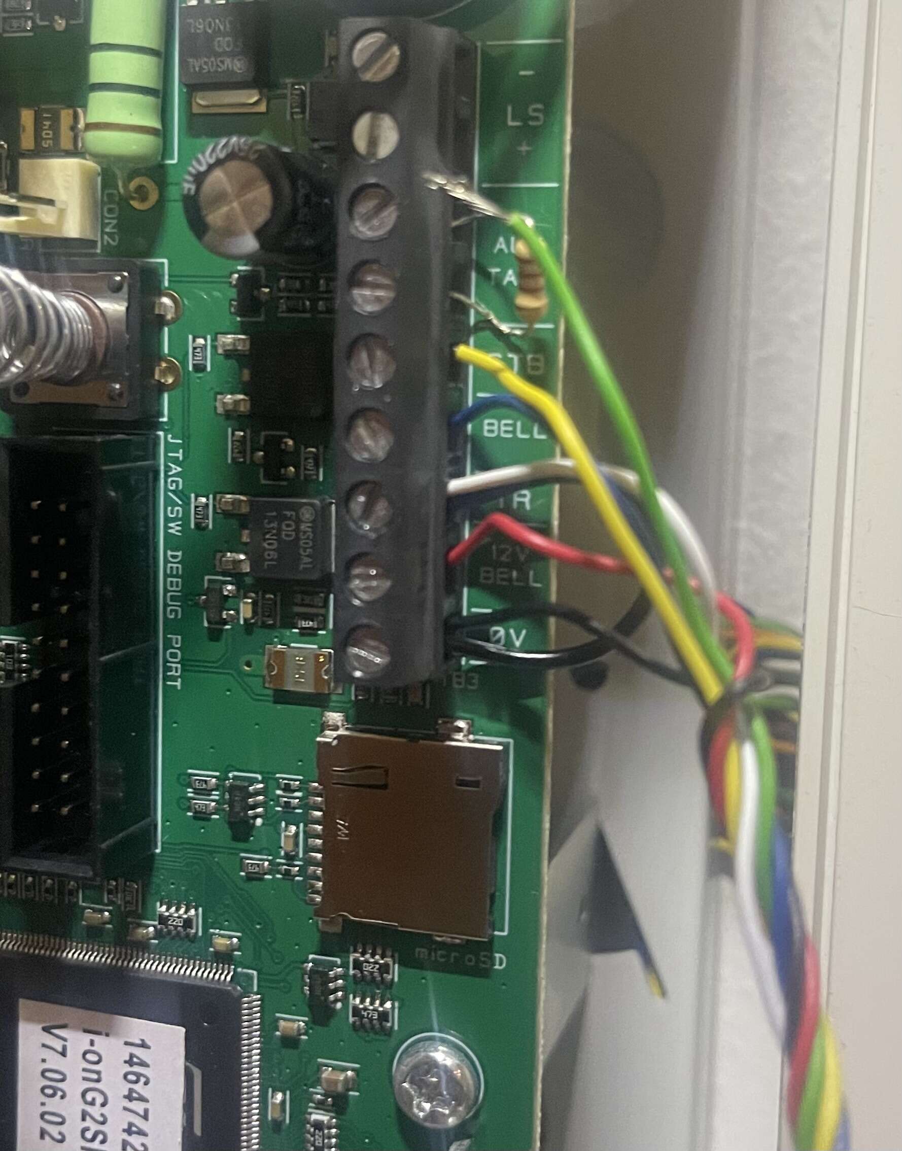

  8. Hi all, Had our Alarm upgraded a while ago, and kept original sounder for various reasons. The panel is an Eaton G2SM panel and the bell / sounder is a Risco Novagard 2. Recently opened the panel to check the exact model, and noticed the green wire from the sounder isn’t connected at the panel end. Everything seems to work ok, the sirens sound and the lights flash when the Alarm is set off and the red LED’s run when not armed. Anyone have any thoughts on how this wire should be connected and whether the rest of the sounder wiring looks ok? Any advice welcome. thanks Nate.
