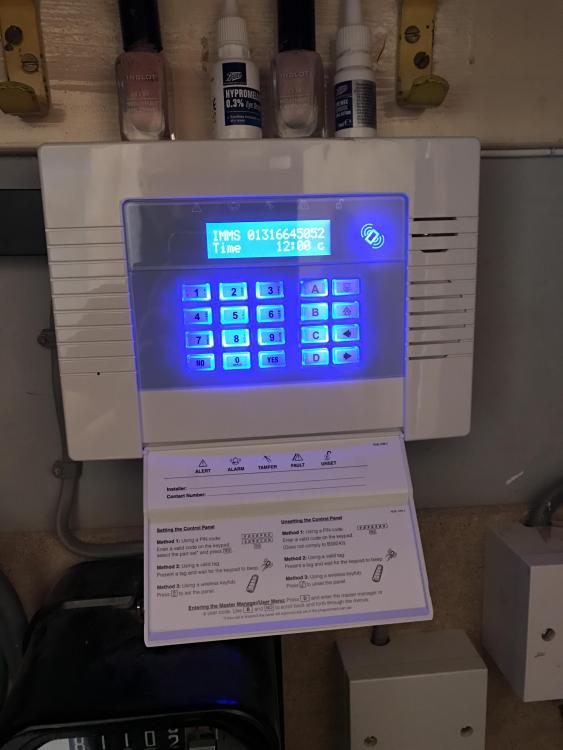

    The engineer then tells me his boss is lying to me and there is NO 3 month cancellation period and I'm entitied to cancel whenever I want. He said Rather than my panel being connected to the 0844 number he can programme it so if alarm is set off it will send me a text msg to my mobile telling me where and when it's went off.. seemed like a good Idea so went ahead and done this. He set alarm off and panel sent me text msg. All good..

  7. I've Cancelled the monitoring with the company and decided to go unmonitored till I find another company who come well recommended to avoid any further issues.
    In the meantime how can I clear my keypad of the previous companies info and any monitoring station phone number to make sure my alarm doesn't call out to 0844 number costing me money?
