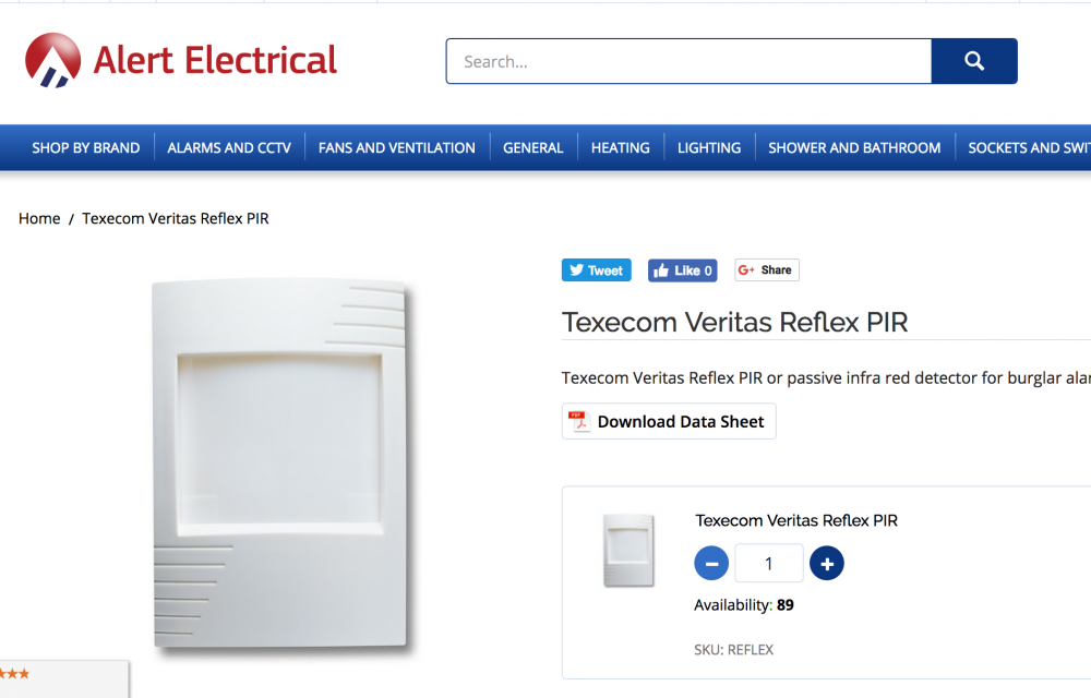

  1. I'd be happier just buying a new PIR, I got the system fitted 15 years ago, so do I need to put in the engineer code, then turn off the 240 supply then change PIR?

  4. Ok, I guess I'll get a new PIR as the rest of system works fine the false alarm only started 2 days ago. If I do a walk test the sensor activates ok, but today after setting alarm and laeving the house the same false alarm happened within about 20 seconds.
  5. Does it sound as though it could be a faulty PIR?
