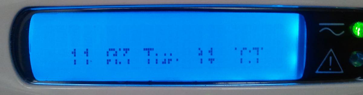

mandem Posted October 4, 2011 Share Posted October 4, 2011 Hi All, I have a Menvier M800 and two mkp2 keypads, however recently (over the last year) I started getting issues with the LCD display. On both keypads, the LCD display has become pixelated. Some of the text/characters are chopped or missing, looks like a faulty display. (See attached) Has anyone seen this issue, is it a faulty LCD? Is there a way I can replace the LCD, or would I have to purchase replacement keypads? Many Thanks Link to comment https://www.thesecurityinstaller.co.uk/community/topic/32115-mkp2-lcd-issues/ Share on other sites More sharing options...
fozzies Posted October 5, 2011 Share Posted October 5, 2011 Sounds very much like 2 faulty kpds to me. everything is surface mount these days, so very difficult to replace even if u do manage to source a replacement, very fiddly work with a soldering iron! Link to comment https://www.thesecurityinstaller.co.uk/community/topic/32115-mkp2-lcd-issues/#findComment-277673 Share on other sites More sharing options...
mandem Posted October 5, 2011 Author Share Posted October 5, 2011 Thanks!!! had a feeling i would have to get replacement keypads, just wanted to confirm. Many Thanks. Link to comment https://www.thesecurityinstaller.co.uk/community/topic/32115-mkp2-lcd-issues/#findComment-277675 Share on other sites More sharing options...
fozzies Posted October 5, 2011 Share Posted October 5, 2011 Personally i wouldnt replace them if i could read the display, it wont affect the running of the alarm in any way, its just the lcd that is faulty, not the electronics controlling it. Link to comment https://www.thesecurityinstaller.co.uk/community/topic/32115-mkp2-lcd-issues/#findComment-277676 Share on other sites More sharing options...
