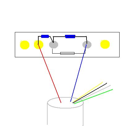

andyrav Posted October 5, 2007 Author Share Posted October 5, 2007 OK think i have sorted it, down to a setting on the zone now. One more question . how to you wire up a door magnet to a zone, where do you put the resistor? thanks for all your help everyone. Link to comment https://www.thesecurityinstaller.co.uk/community/topic/20922-galaxy-16-wiring-pir/page/3/#findComment-180332 Share on other sites More sharing options...
ScorpioInstallations Posted October 5, 2007 Share Posted October 5, 2007 OK think i have sorted it, down to a setting on the zone now.One more question . how to you wire up a door magnet to a zone, where do you put the resistor? thanks for all your help everyone. Never Teach Your Apprentice Everything You Know Link to comment https://www.thesecurityinstaller.co.uk/community/topic/20922-galaxy-16-wiring-pir/page/3/#findComment-180333 Share on other sites More sharing options...
andyrav Posted October 5, 2007 Author Share Posted October 5, 2007 Thank your awesome What is the best resistor to use between the contacts? 1K2 0.25W CF RESISTOR or 1K 0.25W CF RESISTOR Link to comment https://www.thesecurityinstaller.co.uk/community/topic/20922-galaxy-16-wiring-pir/page/3/#findComment-180335 Share on other sites More sharing options...
ScorpioInstallations Posted October 5, 2007 Share Posted October 5, 2007 Thank your awesomeWhat is the best resistor to use between the contacts? 1K2 0.25W CF RESISTOR or 1K 0.25W CF RESISTOR Stop! 1K Brown, Black, Black, Brown,Gold (Gold=5% Tolerance) Never Teach Your Apprentice Everything You Know Link to comment https://www.thesecurityinstaller.co.uk/community/topic/20922-galaxy-16-wiring-pir/page/3/#findComment-180337 Share on other sites More sharing options...
andyrav Posted October 5, 2007 Author Share Posted October 5, 2007 Where is the best place to buy resistors? I only have Brown, Black, Red, Gold brown, red, red, gold Link to comment https://www.thesecurityinstaller.co.uk/community/topic/20922-galaxy-16-wiring-pir/page/3/#findComment-180340 Share on other sites More sharing options...
ScorpioInstallations Posted October 5, 2007 Share Posted October 5, 2007 Where is the best place to buy resistors?I only have Brown, Black, Red, Gold brown, red, red, gold Same thing, yours are 4 band rather than 5 Never Teach Your Apprentice Everything You Know Link to comment https://www.thesecurityinstaller.co.uk/community/topic/20922-galaxy-16-wiring-pir/page/3/#findComment-180341 Share on other sites More sharing options...
