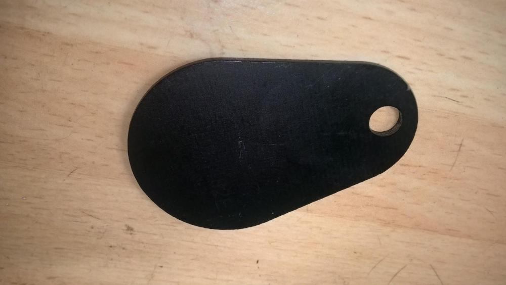

  2. when i add them as above the touch screen displays numbers it has got from the fob and the fob then work even though the numbers are not the same as the numbers and letters on the fob its self. if i then upload from the panel via RRS it shows all the users fob numbers linked to there accounts but again its all numbers which dont match the fobs details.
  3. These are the fobs being used on site and work fine on the keypads. only thing is i can add them as i said above but if i was to enter the fob number in manually there is both numbers and letters on the fobs?
  4. Hi GG yes the bootup is from me rebooting the panel. the fobs was added via the touch screen by adding a user then pressing learn card and holding the card to the screens prox. the fobs all work fine on the keypads and allow you to operate the system but when i use a fob on the reader it just crashes the system but i can login to the minic panel and egress the door and the reader opens the door and i had even setup a time schedule for the door to have free access at set times which also worked fine. its just not happy with fobs
  5. Hi Both looking at the log its saying ill-code and wrong cd both at same time from max40 which is the only Max4 on the system but then the next entry after that is boot-up this is at the time when i try a fob on the reader.
  6. Hi All I'm working on a Honeywell galaxy dimesion panel 520 V6.7 which i installed a few years ago. all is well with the panel until i have come to install a MAX4 reader V1.77 for a access door. this is currently the only MAX4 on the system. I have followed the install instructions and double checked the wiring for the RS485 and all is correct. I have also added the MAX4 to the system and given it address 0 on network 4, there is nothing else on network 4 using address 0. the issue I have is the reader appears to be working fine until you try to use a fob and 1 out of 3 times it will work fine, the other times the system goes into alarm saying Alert on the keypads but it will then not allow you to enter a code as the system seems to have locked up or crashed and you have to reboot the main panel in order to get the system working again. After you reboot the main panel all is fine again until you try using the MAX4 again. If anyone can help with this or has come across this also please let me know as I'm stuck with what to try next. Thanks Dan

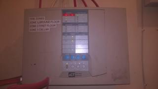

  9. Its the panel at fault. Zone 1 had a fault last week and could not find any issue with the circuit. I then move the circuit to zone 4 that was spare and all was well. I then put a EOL on zone 1 and it still showed as fault. Now zone 2 has done the same.

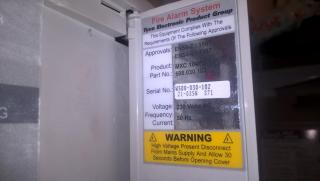

  10. Hi all. Got a faulty adt fire panel which I need to find a compatible replacement for. Could any of you suggest a replacement 4 zone panel? Thanks Dan
