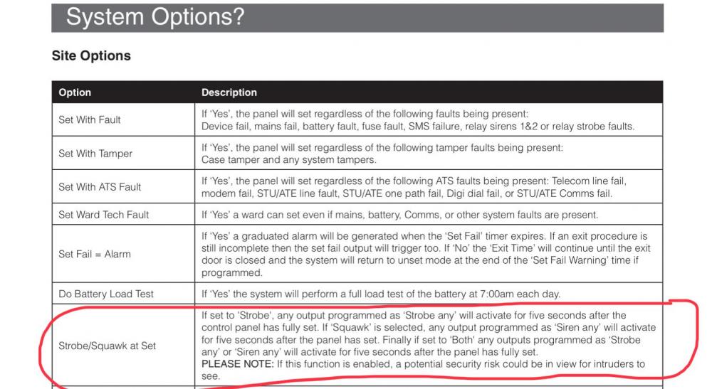

Are you looking for the strobe to give you conformation of setting /unset coopers panels can give you a 3 strobe flash on both so might be in setting progg
