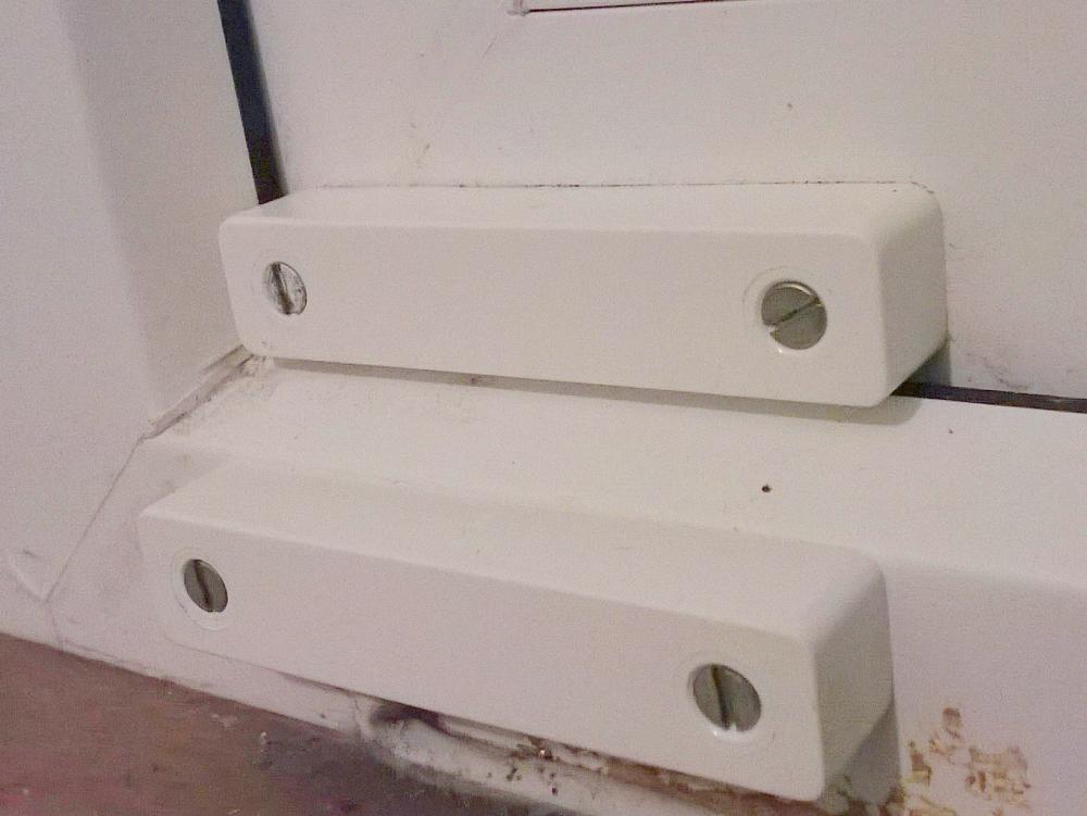

Eugene's DIY Den Posted October 10, 2017 Share Posted October 10, 2017 So a lot of my contacts need to be replaced, most of them on windows which are never really opened. A few are on doors and windows which are regularly opened. The switches are sticking closed. Is this typical if the reed switches aren't "exercised"?, or did I just get low standard switches when I installed my alarm almost 20 years ago? Quote Talking Tools, a Facebook group for discussing anything tool/DIY related. Link to comment Share on other sites More sharing options...

Eugene's DIY Den Posted October 10, 2017 Author Share Posted October 10, 2017 Two more questions! Do magnets lose their strength over the years. I tested a new contact I replaced with both the old and new magnet. Both contacts opened when the magnet on the window moved outwards 1 cm. It's probably good practice to replace both contact and magnet? Second question: The PVC windows have a chamfered edge, so I can't butt the contact up against the magnet because it would be proud of the window opening and likely to get knocked if anything is passed through the window. At the moment, the contact only opens when the casement is pushed out 1 cm. Tapping the contact hard doesn't seem to open it when the window is closed, so the reed switch seems to be securely closed. Do you think this is good enough, or am I going to have problems down the line with nuisance triggering because the pair aren't close enough? Quote Talking Tools, a Facebook group for discussing anything tool/DIY related. Link to comment Share on other sites More sharing options...

Eugene's DIY Den Posted October 10, 2017 Author Share Posted October 10, 2017 (edited) 52 minutes ago, MrHappy said: IIRC 13mm operating gap, thats look way too far apart The bottom edge of the magnet to the closest edge of the contact is 11mm. Edited October 10, 2017 by Eugene's DIY Den Quote Talking Tools, a Facebook group for discussing anything tool/DIY related. Link to comment Share on other sites More sharing options...
MrHappy Posted October 10, 2017 Share Posted October 10, 2017 3 minutes ago, Eugene's DIY Den said: The bottom edge of the magnet to the closest edge of the contact is 11mm. there on surfaces which are stepped apart, a "chunky contact" does 30-40mm gap I wouldn't fit then in the locations you've got 1 Quote Mr Veritas God Link to comment Share on other sites More sharing options...
Eugene's DIY Den Posted October 10, 2017 Author Share Posted October 10, 2017 (edited) 6 minutes ago, MrHappy said: there on surfaces which are stepped apart, a "chunky contact" does 30-40mm gap I wouldn't fit then in the locations you've got What would be the consequences of spacing the pair this far apart? Edited October 10, 2017 by Eugene's DIY Den Quote Talking Tools, a Facebook group for discussing anything tool/DIY related. Link to comment Share on other sites More sharing options...
MrHappy Posted October 10, 2017 Share Posted October 10, 2017 If the gap is too wide the reed may not close / may open after a period of being set Depending on the case design you mage be able to double up the magnets which give them more "pull" Quote Mr Veritas God Link to comment Share on other sites More sharing options...
Eugene's DIY Den Posted October 10, 2017 Author Share Posted October 10, 2017 (edited) 9 minutes ago, MrHappy said: If the gap is too wide the reed may not close / may open after a period of being set Depending on the case design you mage be able to double up the magnets which give them more "pull" I could probably piggy-back the magnets and use long screws. I would prefer to keep the contacts off the chamfer if possible, plus the wiring would have to be stretched (mightn't be possible) , plus holes where the contacts were, left visible in the window. About 22 pairs are like this. Edited October 10, 2017 by Eugene's DIY Den Quote Talking Tools, a Facebook group for discussing anything tool/DIY related. Link to comment Share on other sites More sharing options...
al-yeti Posted October 10, 2017 Share Posted October 10, 2017 3 hours ago, Eugene's DIY Den said: I could probably piggy-back the magnets and use long screws. I would prefer to keep the contacts off the chamfer if possible, plus the wiring would have to be stretched (mightn't be possible) , plus holes where the contacts were, left visible in the window. About 22 pairs are like this. Looking at that frame it's messed up, you could drill in and out from the chamfer if your going enough If you ever remove the contacts which I doubt you can always have all the upvc repaired these days but if it's your windows you can do as you need to www.upvcdoctor.co.uk They normally charge for a set of windows in the big scheme of things it's cheaper than trying replace or bodge it yourself Or similar companies that was an example Quote Link to comment Share on other sites More sharing options...
