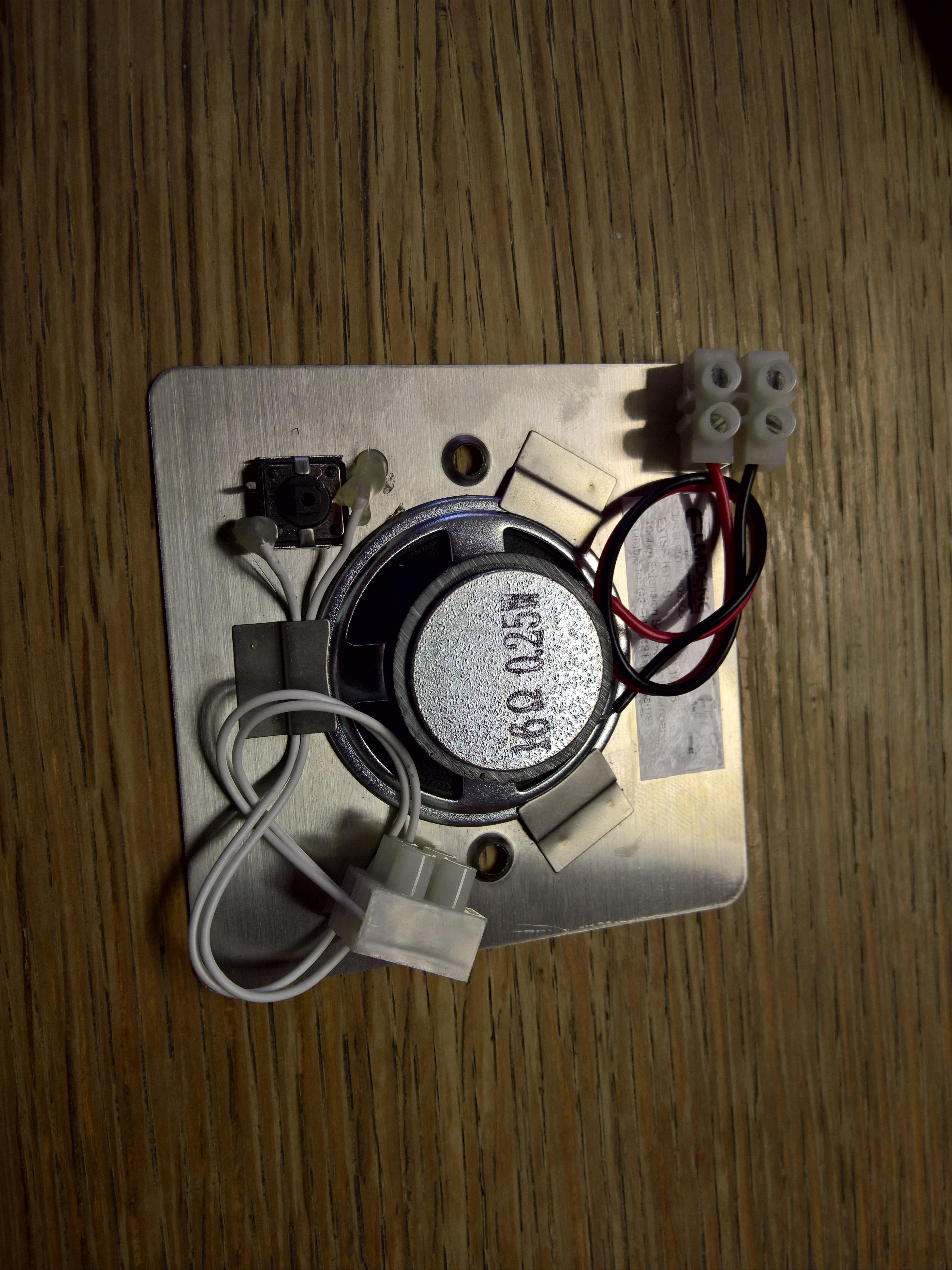

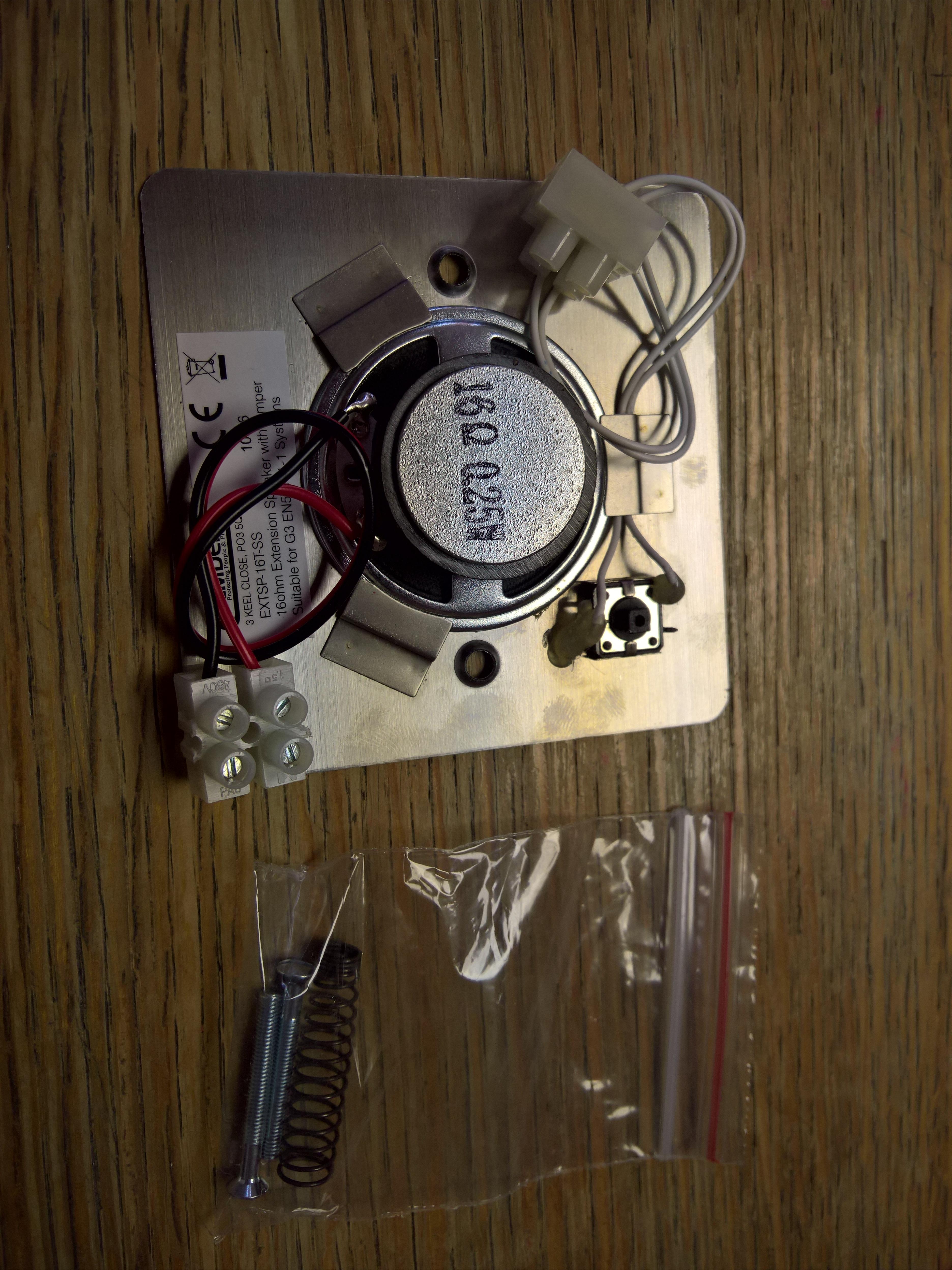

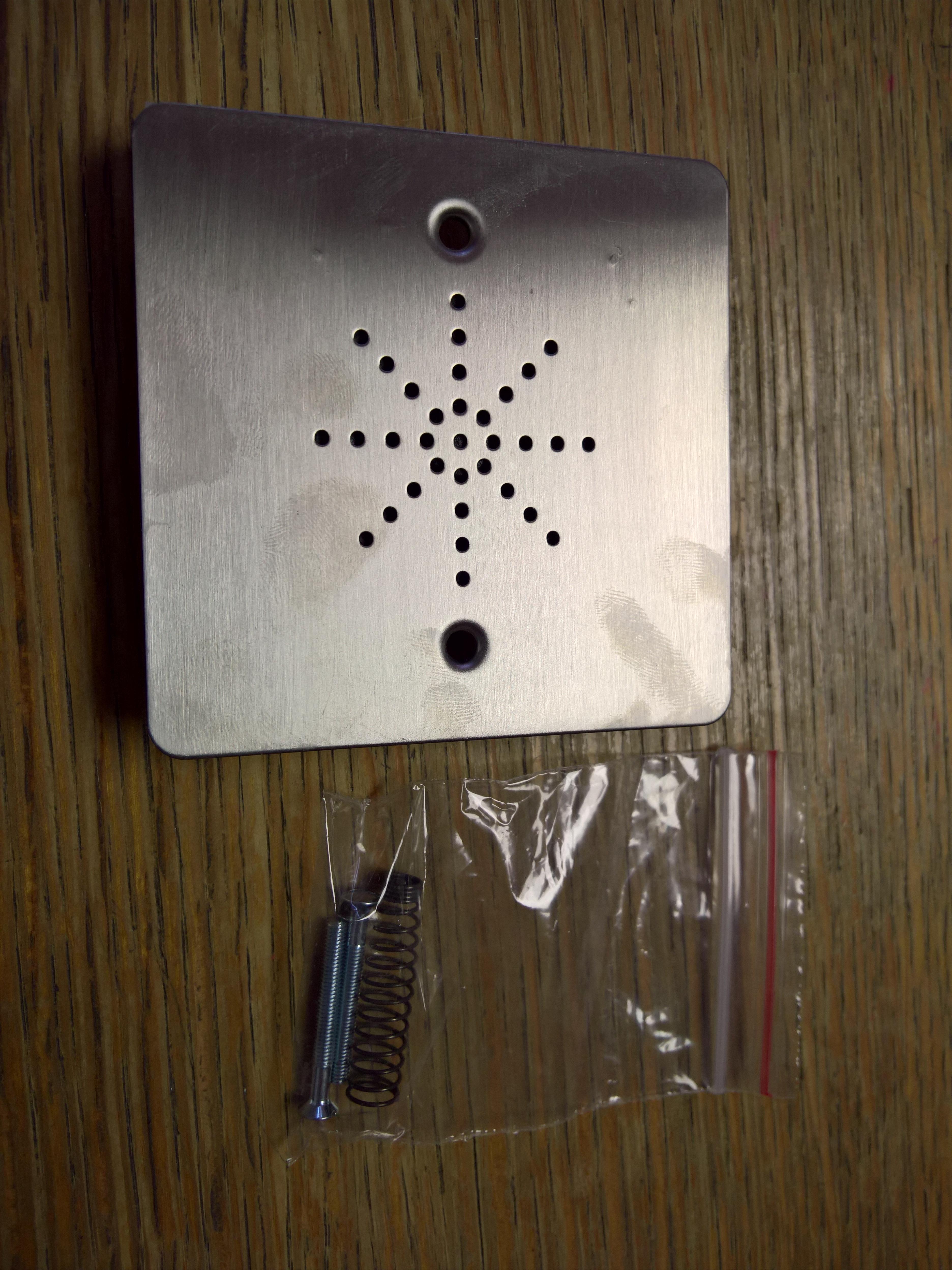

datadiffusion Posted March 3, 2017 Share Posted March 3, 2017 (edited) Hmm, a second, longer spring would have been nice, you never know what's been fitted esp. if someone else is doing the 1st fix. Also I assume that tamper is just glued on? And as usual no 3rd terminal for a resistor Edited March 3, 2017 by datadiffusion Quote So, I've decided to take my work back underground.... to stop it falling into the wrong hands Link to comment Share on other sites More sharing options...

sixwheeledbeast Posted March 4, 2017 Share Posted March 4, 2017 for the pics JW. Tamper button looks secured by metal tangs to me, DD. I think I would use them in a new build/rewire scenario, probably stick to CQR Alto for other stuff instead of the surface box option. Quote Link to comment Share on other sites More sharing options...
datadiffusion Posted March 4, 2017 Share Posted March 4, 2017 Yep you're right. JW in your opinion would the spring be ok for a back box up to 45mm box plus extra skim depth? Quote So, I've decided to take my work back underground.... to stop it falling into the wrong hands Link to comment Share on other sites More sharing options...
